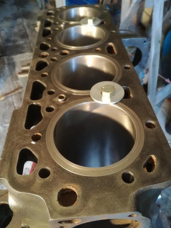

Did some more work on the engine block this weekend. Looks much better now. Oil channels cleaned. Also tried to polish the crankshaft. Parts did arive already a2 weeks ago, so almost can't wait to start the rebuild.

Have you had the head skimmed, new valve guides pressed in, seats reground to mate with new valves?

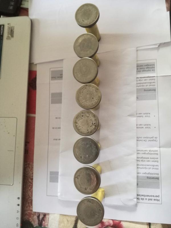

Just a quick question:
Are these repairable? Some are not that flat also.
Seems like the engine had bad lubrication or something.
Re: engine overhaul
Show traktor ok,heavy Duty no-go IMO
How are the cam lobes
- Posts: 792
Re: engine overhaul
cam shaft will be a new one, the old one has a lot of wear on some lobes (not all!)SvendH wrote:Show traktor ok,heavy Duty no-go IMO
Re: engine overhaul
I think it would be a waste to use worn followers with a new camshaft,they will chew up the the new lobes
Re: engine overhaul
Cam followers could be re-surfaced but: they are not meant to be flat; rather slightly concave to accommodate the lead in and out of the cam lobe.

Resurfacing is also a possibility although her in denmark that would cost as much or more than a new set.
What about going to a breaker? there is a good chance you could find a set of cam+followers in ok condition ,save money and still get a sweet running engine.
Alternativley you could just use the old followers, the engine will most likely run just fine with them (use running in paste) but if you end up keeping the engine you will keep thinking " how long to go"

I've ordered some new camshaft followers over the weekend.

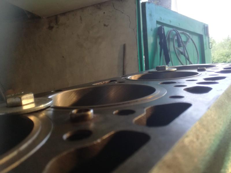

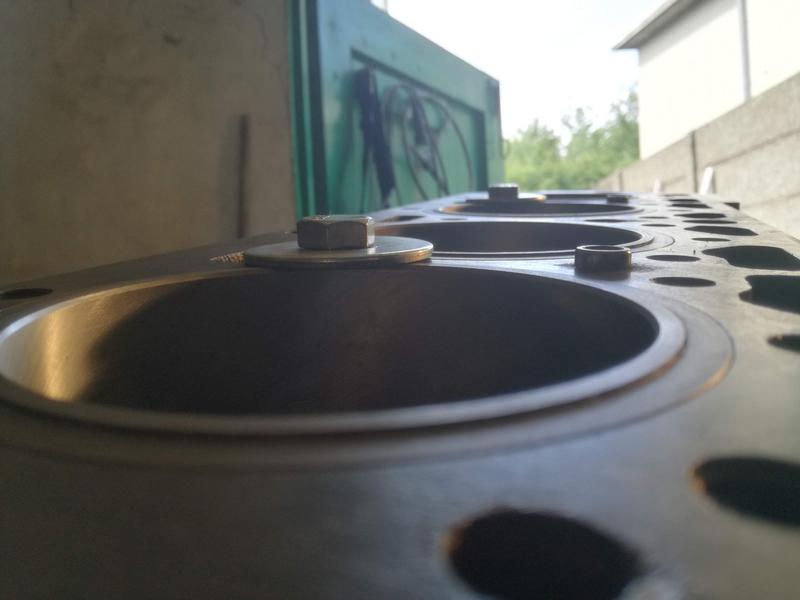

Meanwhile I've been puzzling with the new liners. I used a feelerblade of 0.004" next to the liner and feel if it's flush or not. Not that easy.
I haven't fit the seals yet, should i add extra sealant or just lubricate with engine oil?
