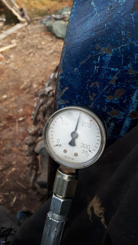

My next quess is pump itself. I tested pressure but I didn´t have "official" hydraulics gauge so I had to use preassure gauge for oxigen gas tank (up to 350 bar). Result was 0 bar without load and 60-70 bar with about 300 kg load. With 300kg load linkage was able raise only 10-20 cm.

Please see first picture. Pressure is measured directly from pump supply line. Valves are not involving measurement.SvendH wrote:Was the tractor lifting Something when you measured 150 bar? Otherwise I dont See how it can build such pressere,are you sure the lift isent jammed somehow.

Pressure directly from pump: idle about 100bar, from 1/2 engine speed to full-> 150bar.oehrick wrote:Is the pressure varying with the engine speed ? i.e. when you rev up do you get more pressure ?? if not I would suspect the pressure relief valve as more revs to the pump should result in more pressure as the oil flow should increase in greater proportion to leakage in the pump mechanism whereas a failure of the PRV would tend to result in the pressure remaining the same or similar.
Systen assembled:
No load: no pressure (any revs)
Load: no pressure at idle
about 70 bar at full speed

I've had a closer look at your test set up for the pump pressure, have you bolted a plate on so you can have a tapping for your test gauge pipe ? if this is the case then the block which the pressure relief valve is fitted is missing, in which case and by coincidence your maximum pressure developed at no flow is about the same as the normal system pressure )2000-2200 PSI or 135.6 - 149 BAR Despite your shimming and cleaning it may be that the pump wear is the root cause of your problem.
With the lift valve lever down oil cimply recirculates at virtually no pressure back into the back axle housing.
With the lift lever up and 70 bar measured it still indicates that you may have
PRV leaking
Other part of the oil / valve route leaking or not operating properly
Ram leaking
Ram or mechanism seized as with no implement on the lift arms I would expect some lifting motion.
Did you check when it was open that the piston can be moved ? if not block the arms in a high position and see if you can manually push the piston and with the arms released that it returns.
Or we are all missing a vital clue

Ram works with out load. Can lift load about 200kg with full engine revs.
With load, engine idle, lever up, no pressure. Engine with full revs, lever up, pressure about 70bar (max)
