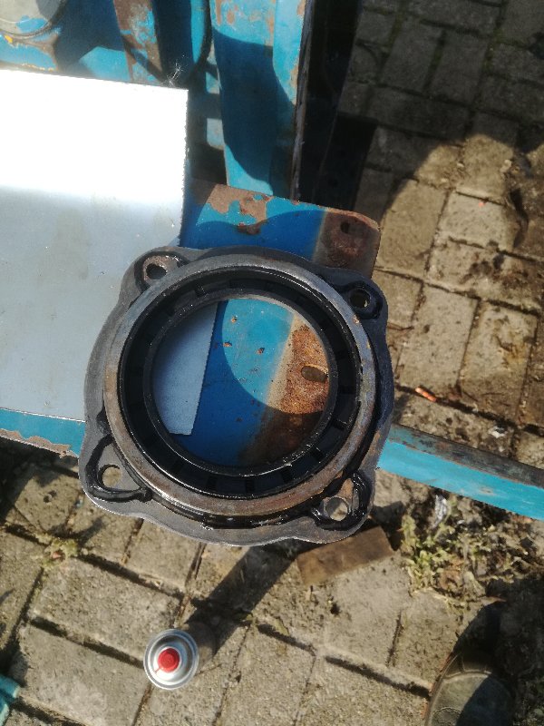

Today I have been working on my Super 4 and I found out I have the wrong seal.
It would be interesting at what year/model the changed the seals.
The double lip seal I have has an inside diameter of app 44mm. I found 2 single lip seals in the Pto dropbox with an internal diameter of app 54mm.
What I thought to be an easy job (did it before on my super major), seems to be a long job with a lot of problems:

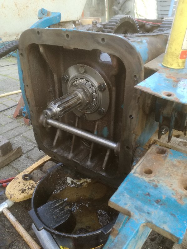

What an engineering: try to get it out of there!

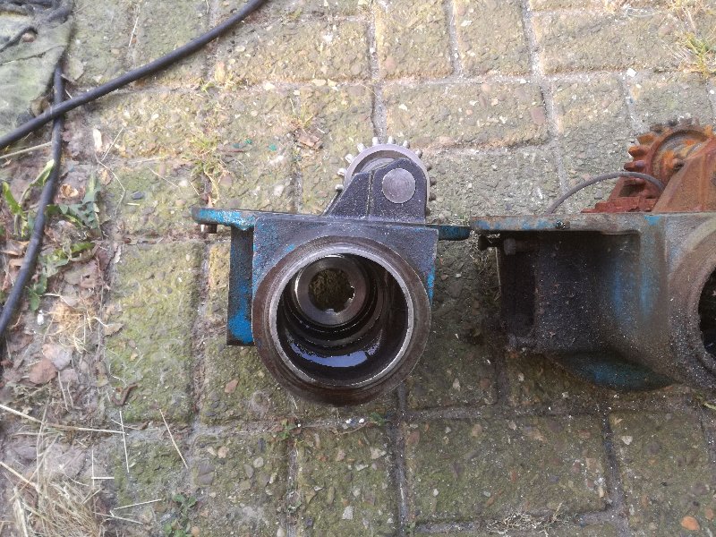

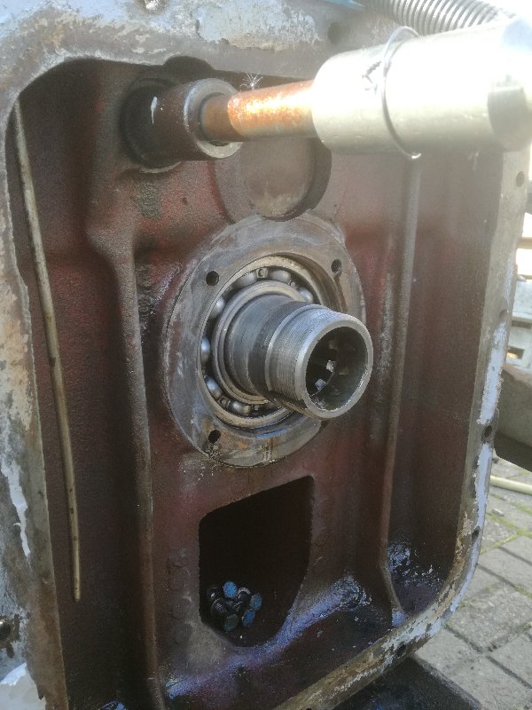

Notice the short shaft in the picture, this is part of a reduction gearbox (don't know if this is a county one or howard). When taking out the pto shaft, this stays in place.. So a lot of fiddling to have it disconnected.
The 2 different seals.

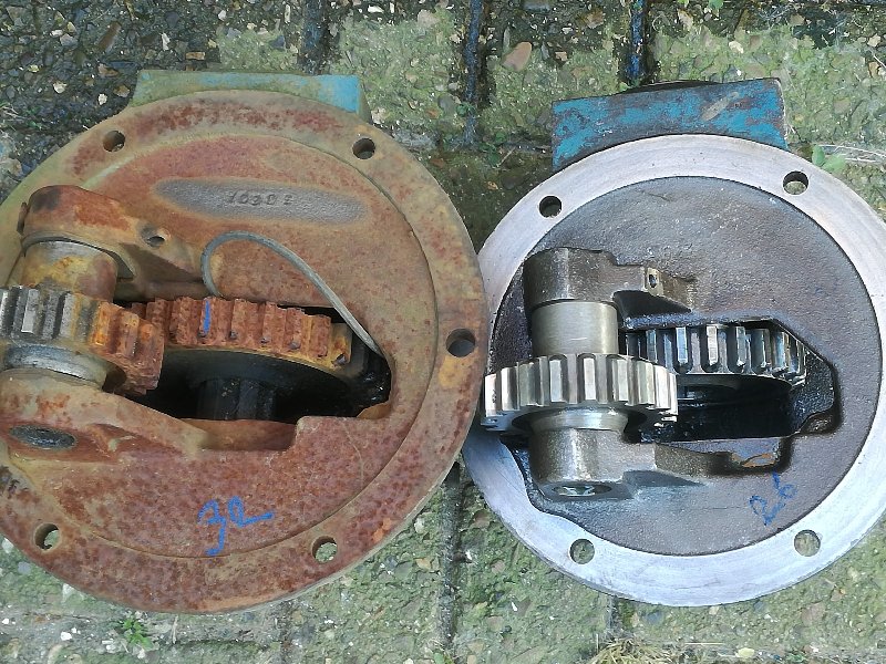

I find this a very interesting topic. The new performance major has some special secret features 8)

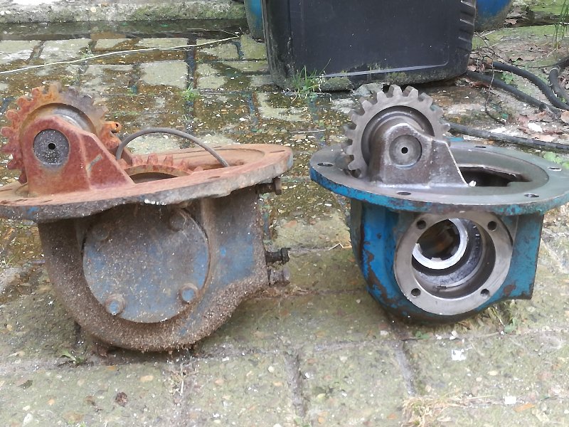

I dig out the spare new performance pto box I've got and made some pictures next to the normal one.
Have fun (the rusty one is the NP drop box)!

In practice I doubt that anyone will come across an earlier PTO gearbox that has had the later shaft fitted during a rebuild, because during a blow up of the earlier PTO gearbox the shaft was not usually damaged, it was the actual casting and the gears that took the damage.
The pictures of the earlier PTO gearbox and the New Performance gearbox posted by mathias show that the New Performance gearbox is a much sturdier piece of kit with a much heavier casting that was nearly 50mm bigger in diameter where it met up to the underside of the main gearbox. The main gearbox itself had a larger opening to take the new casting and the main gearbox case itself was also much heavier and stronger than the earlier models. Hence the cases and units of the later models are not interchangeable with the earlier models.
When you look at the New Performance case you will notice that it is deeper to accommodate the larger driven gear that is on the bottom output shaft where the seal in question is located, this larger gear now had 32 teeth instead of the 26 teeth on the earlier gear and was the main factor in the change in the PTO drive ratios that gave a PTO speed of 540 rpm at an engine speed of 1473 rpm on the New Performance tractor. Note also the two lugs that carry the intermediate shaft and gear have been significantly strengthened with bigger webs to support them, and therein is another of the main reasons for the new heavier PTO gearbox on the New Performance tractors. The earlier Major, Power Major and blue/orange Super Major tractors ran at 1200 engine rpm to provide 540 rpm at the PTO shaft, and the horsepower delivered at the shaft at 540 rpm was only about 32hp. The engine developed peak torque at 1200 rpm, that is why that speed was chosen. This was fine in the early days when PTO driven implements were mainly mowers and trailed combines that required only low horsepower, but as forage harvesters, rotavators and rotary muckspreaders appeared and balers began to be more and more PTO driven and not engine driven then the shortcomings in the early PTO system were exposed. With shafts and gears running at low rpm the torque stresses in the shafts and gears were significant as were the shear stresses in the case castings. In addition with the engine running at only 1200 rpm it was difficult for the governor, particularly the vacuum type, to maintain a steady engine speed. What used to happen was that in work the engine used to drop speed and then surge, particularly when baling, and this further added to the torque stresses on the shafts and gears and shear stresses on the castings.
Sometimes under conditions of constant extreme load or surging load the two lugs carrying the intermediate gear and shaft on the early PTO gearboxes would shear off allowing the shaft and gear to become loose. This usually ended up damaging the PTO drive gears and the lower drive gears in the main gearbox. but the lower shaft where the oil seals were fitted usually escaped damage. So this shaft could be re-used if the PTO unit was rebuilt into a new case. The later version of the official workshop manual for the tractors in the PTO section, when outlining the changes that had taken place with the PTO on the introduction of the New Performance tractor, also had advice on the earlier PTO system as fitted to Major, Power Major and blue/orange Super Major tractors, stating that: " On tractors prior to engine number 08C960337, it is recommended that maximum power output be utilised only under steady load conditions". In other words avoid surging loads and extreme constant loads. Ford was aware of the issue over gearbox casting failures on the early PTO gearboxes, but I should hasten to add that gearboxes were not blowing up left right and centre! However occasional failures were encountered.
The New Performance tractor eliminated these weaknesses by having the engine run at 1473 rpm to deliver 540 rpm at the shaft. This allowed the engine to deliver more of the horsepower that it already had and increased the PTO horsepower at 540 rpm to a genuine 42.5 h p as opposed to barely 32 h p on the previous model. In addition, with the increased engine speed and minimec governor the engine was able to hold to a steady speed without surging. The PTO drive gears in the New Performance PTO gearbox and bottom drive gears in the New Performance main gearbox had the ratios changed to accomplish this change, and in addition the gears and shafts had different hardening treatments to make them much stronger. With the larger gear now on the PTO unit bottom output shaft this allowed all the other gears and shafts before it to run at higher rpm thus reducing the torque stresses on those gears and shafts and also shear stresses in the castings. The PTO drive extension tube was increased in diameter by one eight of an inch which was about 3mm, and the size of the PTO selector shaft was increased. The number of teeth on the hydraulic pump drive gear on the PTO extension tube and on the hydraulic pump itself were changed to allow for the fact that at any given engine speed the PTO shaft would now be running slower than previously and a change of ratios was needed to keep pump output up to scratch. These changes, along with the massively strengthened PTO gearbox and main gearbox castings, eliminated (at a late stage in the life of the Major!) what had been a weakness in the original design, and made the New Performance tractor a very useable tractor for PTO work.

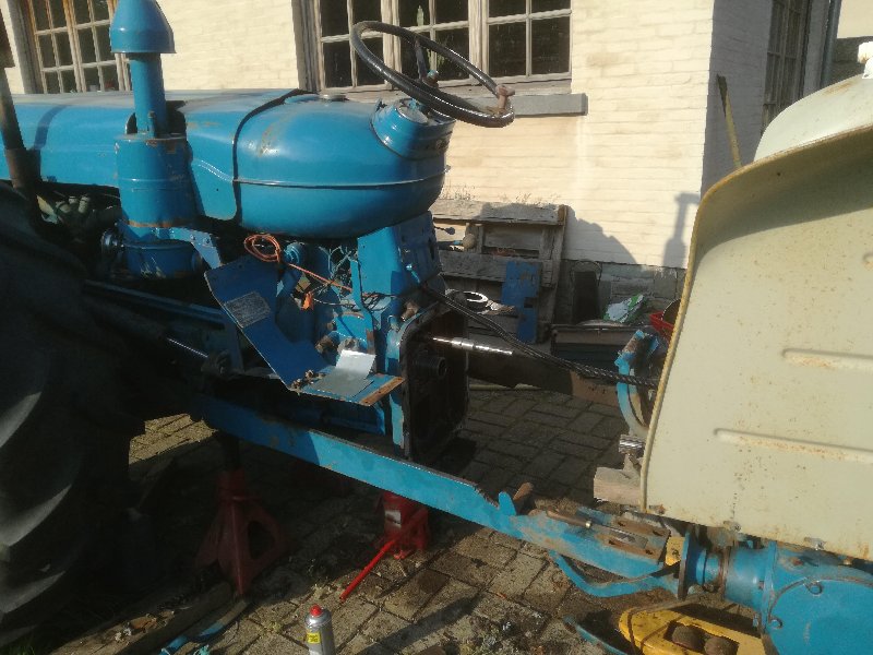

I have it now all back together.
Working on the big list of all the places it can leak... Working my way starting at the back to the front. Next will be the outgoing shaft of the gearbox.
The most difficult ones will be the ones between gearbox and engine, I will have to take out the engine with a engine crane. I hope it can lift the big 6pot engine :eyes:

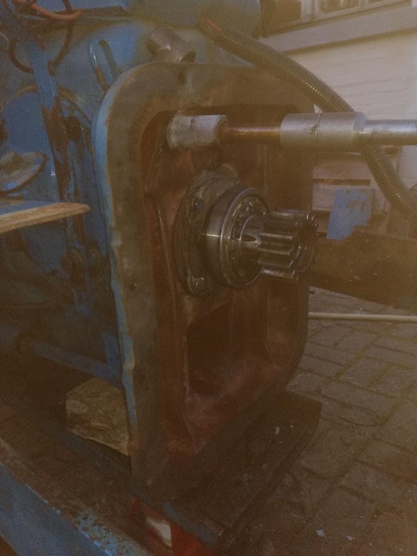

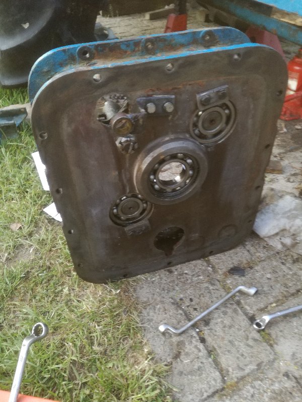

Will do Henk, will do. I got it almost together this evening, but couldn't get the rear axle aligned with the gearbox. So will have to try tomorrow again. I did make some pictures of the Howard reduction box. Quite interesting to see.
Posts: 817
Re: pto gearbox seals
Henk,

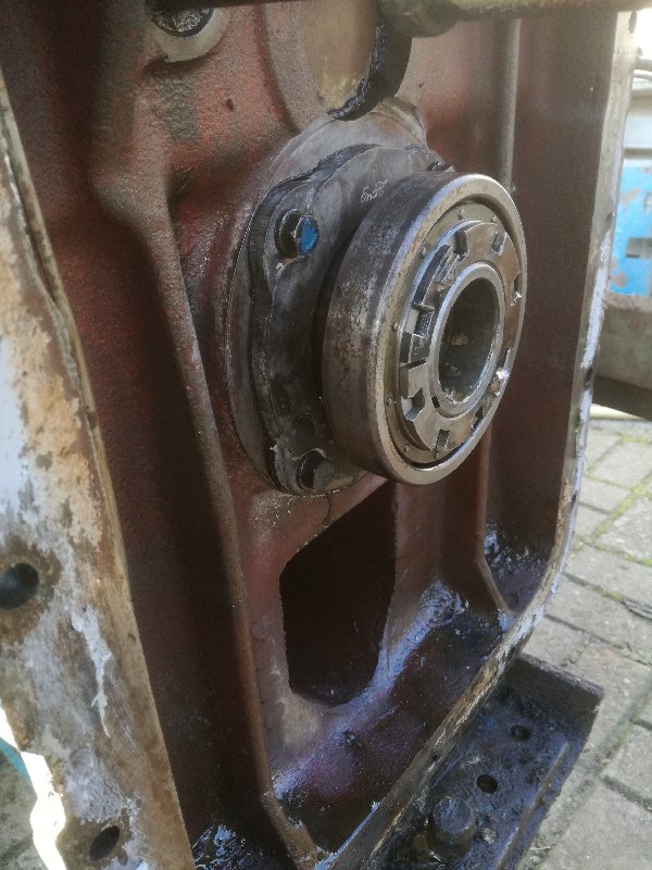

Here are some pictures to replace the seal on the outgoing gearbox axle.
The tractor was delivered new with a 6:1 reduction box.
