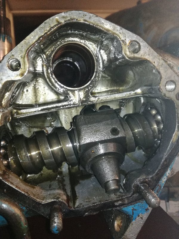

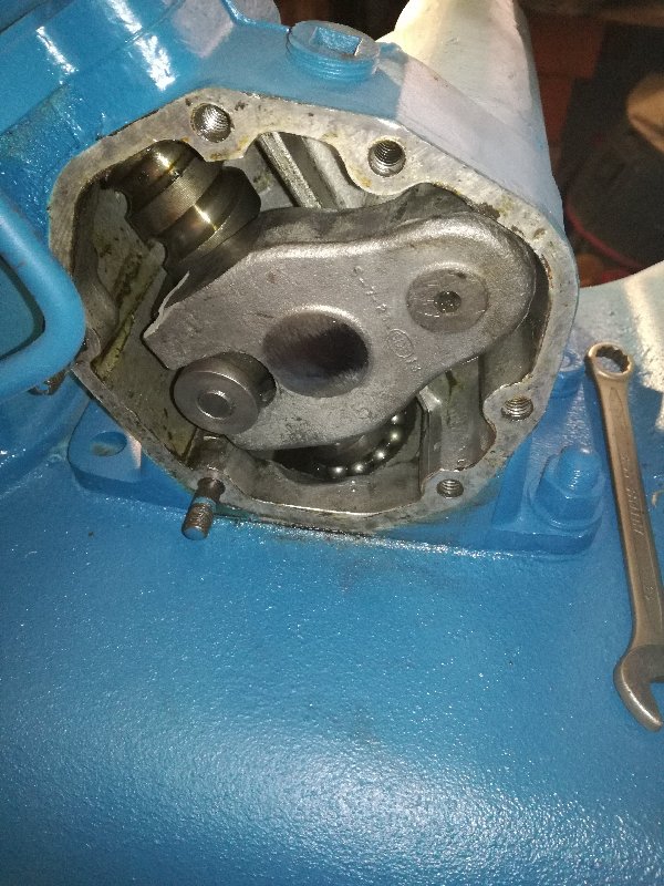

Posts: 817
Re: Steering box
Dave,
these are the pictures of mine (I wish I took more pictures). Maybe you can compare them with your steering shaft.
All I did was cleaning, renewing the seals (didnt do anything on the top bush), taking out some shims and putting in some fresh oil.
you can notice on the last picture the rocker arm is missing a little piece, but it doesn't cause any problems.

Re: Steering box
Post by Daves rusty bits »
Thanks Mathias, yours looks the same as mine did, I`ll have to get the box off again and take more care , I must have missed something the last time. Probably rushed it to get back in to work. I have plenty of time now with the Coronavirus restictions, all my work has dried up and we just have to make the best of it . I`ll post when there`s any progress keep well Dave
