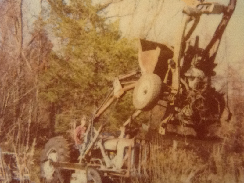

Re: Mounting alternator on Major
From Hyacinths previous life:
Posts: 2389
Nice loader, you might want to inspect the mounting areas for potential overstressing, although from what I can see it looks like you should be fine as the loader is built with a nice frame.
Will do, thanks. The loader is long gone for better or worse. There are some old welds on her, I'll post pictures.
