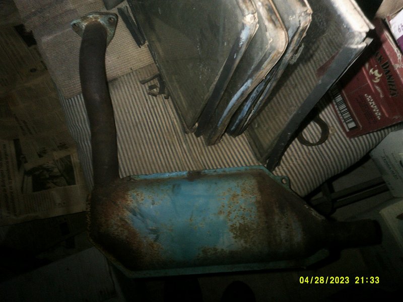

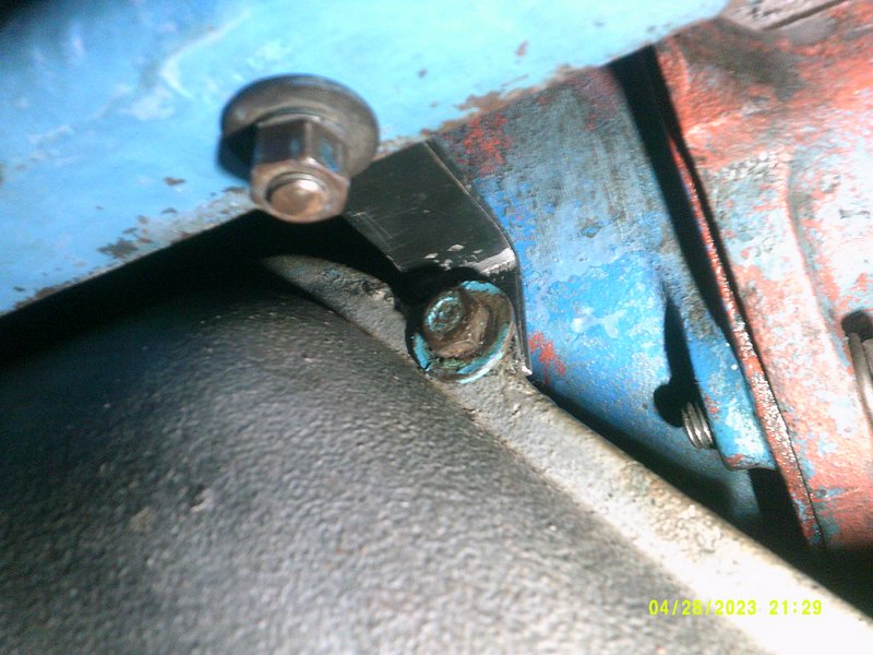

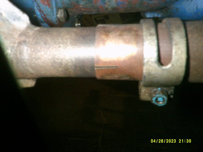

I thought I would revive this thread because of some missing details about the two brackets and clip used in this system. Part no. E1ADKN-5259 holds the rear of the silencer on to the side channel (no pic unfortunately as we only have very non descript remains of Billy's one; made one up for Super Billy)

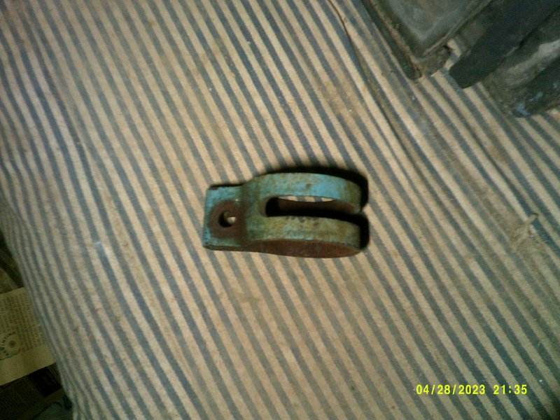

part no. E1ADKN-5260 holds the long pipe on to the silencer

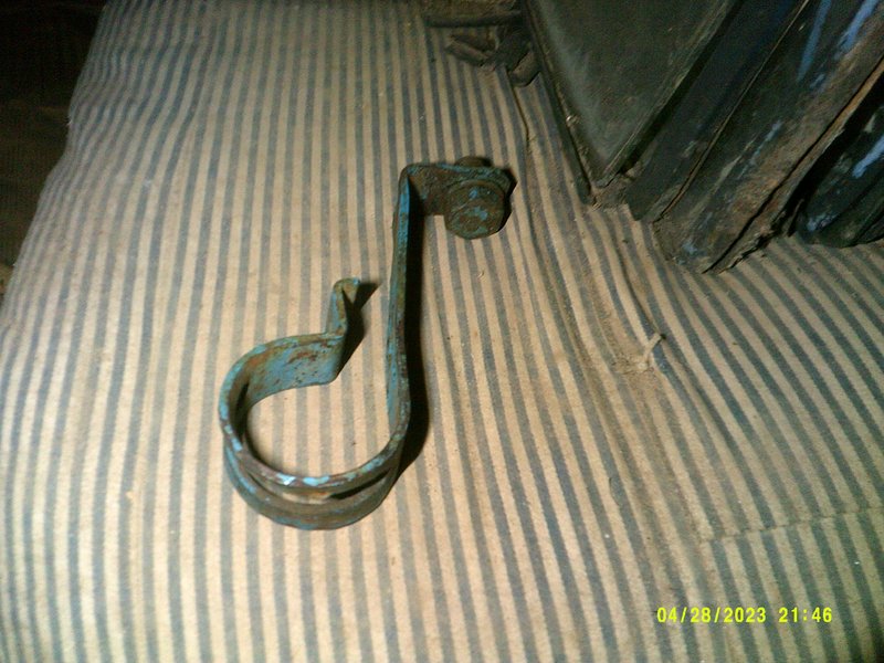

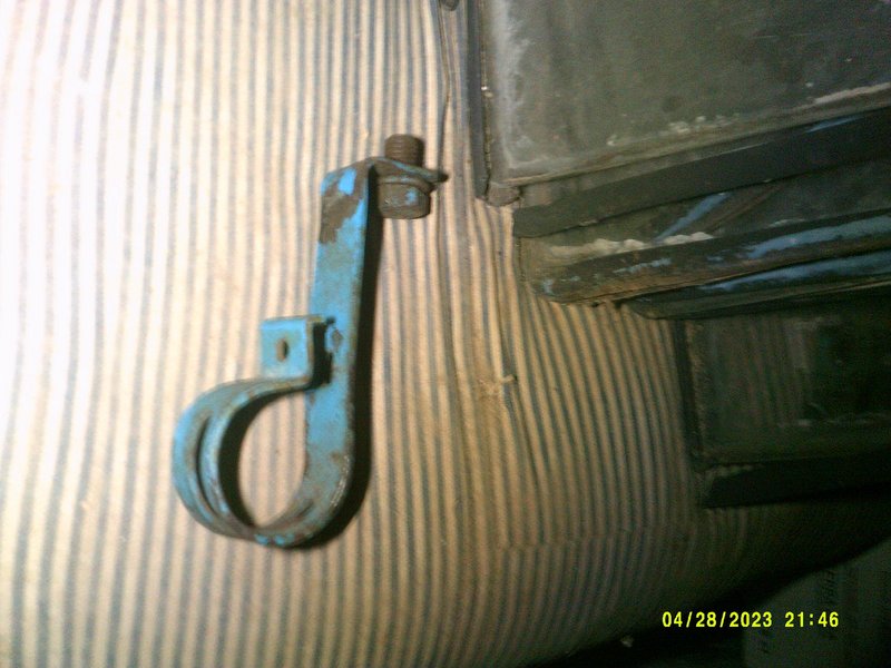

and part no. E1ADDN-5256A (the latest one, there's one for earlier Major's, part nos. E1ADKN-5256A and E1ADKN-5256C, E1ADKN-5256B is the industrial one) holds the tail pipe on to the long pipe and also the axle casting next to the check chain bracket.

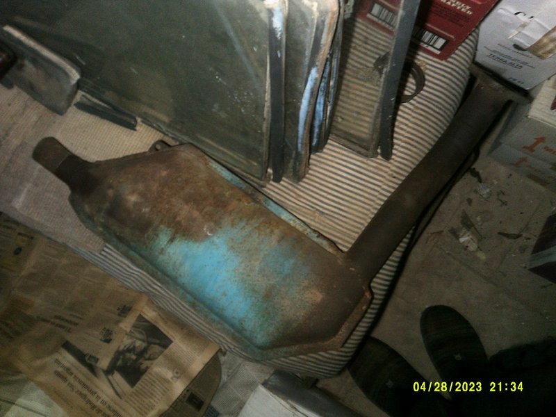

We have two silencers and the vertical section of the third one, two clips, one complete rear bracket and the remains of two more and the remains of one side channel clip (not counting my homemade one).
More pics of the silencer
