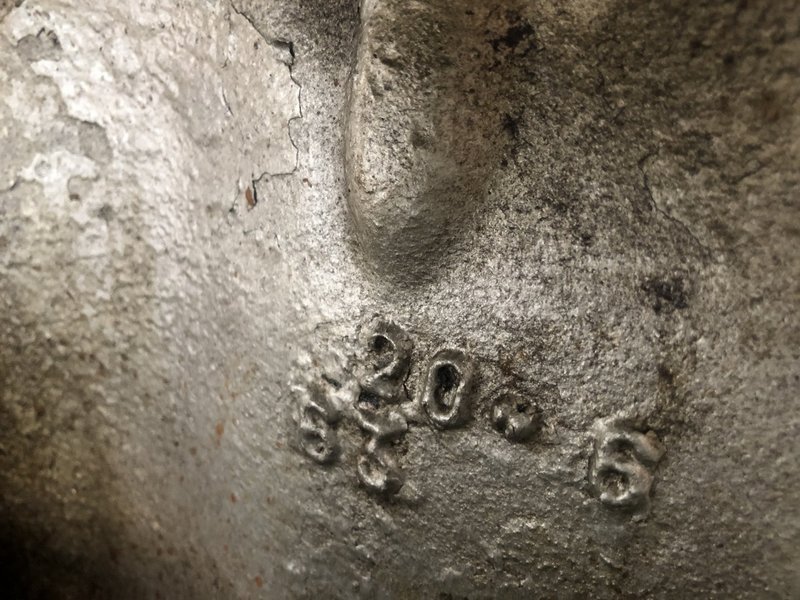

In the past, i have tried to more thoroughly identify my engine to a specific model, to no avail. It has been marinized, sometime long ago in its life, and according to a classic marine engine specialist, who did have some knowledge on fordsons, it has over time become a mixed bag, with some uncommon parts from the norm of the companies that typically marinized them, which made it more difficult for him to assist me. All i know is that it is a fordson major 4 cylinder, he suspected it was a 4D
The main serial badge has been replaced by a number, most likely put there by Ebro, which was the main complication. I would love to have more detailed, concrete information on its make, model and year number so that i can track down more specific information and manuals directly relating to it. Ill attatch some photos and would be so grateful if youd take a look

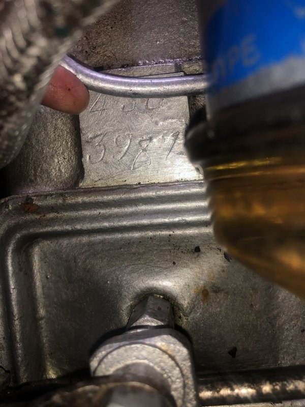

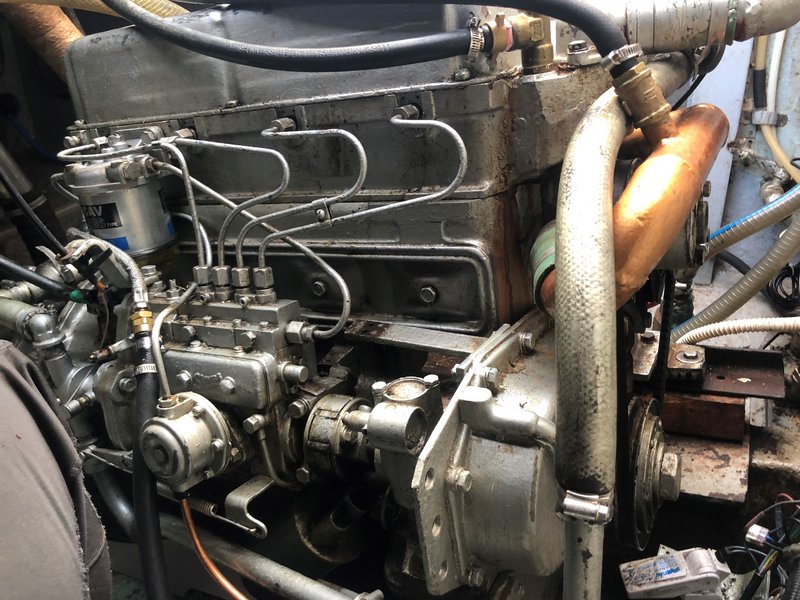

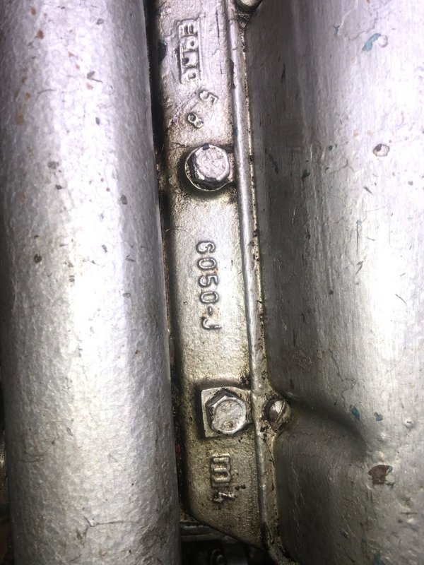

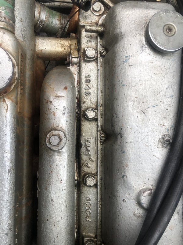

included are all numbers i could find on the engine plus a couple not so close up pictures. let me know if you need anything else to make it easier
Posts: 2560
Re: Tachometer cable too short for for my boat! help please
This confirms it's an Ebro engine. I reckon the block is an earlier casting (20·6·63) not sure if it's a stock casting or a reused block. The head is 18·6·74, so both of them are June, but nearly 9 years appart. The engine number (under injector no. 1, 186960 I would say) fits the period nicely, as should the serial number from the intital digit (4xx3981), unfortunately the crucial second and third digits aren't visible because of the fuel pipe but they should tell us what this is. A view of the RH rear mounting flange, injector pump type, sump and the LH side would be great too, as the sump can be very good for telling the origin of the engine. I can't yet tell you what combination of parts you should be looking for in general (need the pump type for that), but most are the same as an NP Super Major.

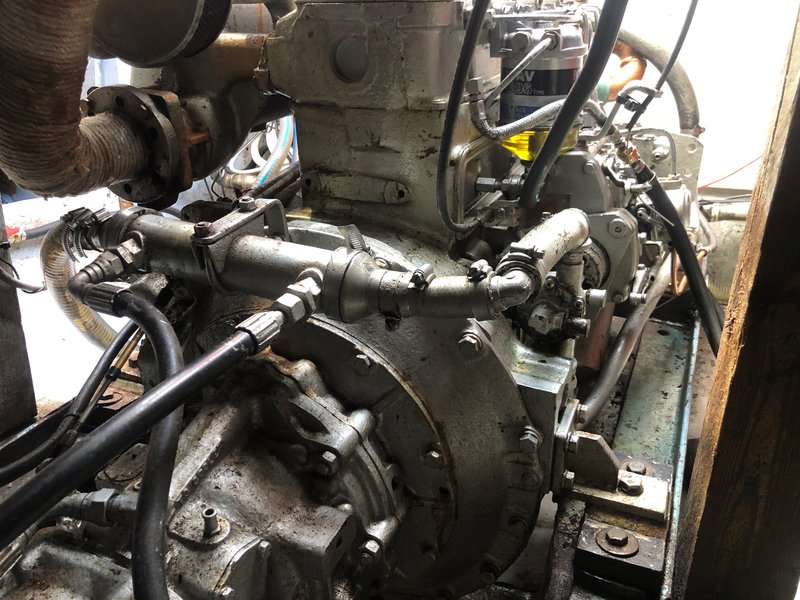

I will look for the pictures Sandy. I hope to replace that engine in the future for a rebuild engine.
The fuel lift pump is mounted on the injection pump. The back of the injection pump might had an air compressor in the past.

Thanks very much Mathias. I think this could be a lorry engine, the pump is certainly not a normal tractor one, and it seems to have the front cover of the exhauster (a later type that Ebro introduced on the D lorries in 1968). Unfortunately I can't quite see the casting codes, the head is 23 January but I can't see the year (probably 74, in the same location as Chris' one) and the block is hidden by the manifold. You seem to have several Ford parts from this tractor's previous engine on this one, which is unusual. The number under injector no. 4 would tell us for sure what this engine was first fitted to.
