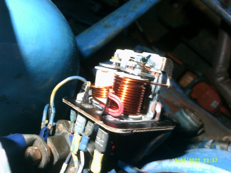

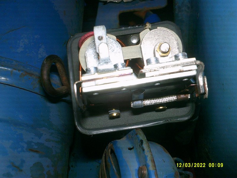

The regulator does indeed mount vertically, with the cover facing the LH side. In the third pic I can see the solenoid bracket, the solenoid fits behind that. You seem to have a Mk2 air filter (used from 1425097 to 1481091), not a very common one and one that was not made to hold the regulator. For sorting this I suggest you do what Ebro did (Ebro never fitted the regulator to the air filter), making a bracket to bolt onto the battery tray like the solenoid bracket and have the regulator as you see here on Super Billy (note Ebro had a combined bracket) (here you see the rubber plugs removed to show how to adjust it, if you don't have the plugs the cover needs to be off for this, you'll need a good voltmeter to set this up):
While it's still off take the cover off and reset the clearances as shown here https://traction-owners.co.uk/wp-conten ... ontrol.pdf
This is what there is inside Super Billy's regulator:
I definitely recommend you reset the regulator and also polarise the dynamo (touch the dynamo F terminal with the negative battery pole, making sure you connect any isolation switches you might have, or if the dynamo isn't on yet also connect the body to the battery positive pole; all this assuming you keep the original positive earth, if not reverse all the polarities in what I just said) as then you'll get top charging.
The Lucas manual I just posted is well worth reading, as it's very good and it even mentions Fordson when comparing the extremes of the regulator series and load coils turns. There are others around with other electrical parts being covered.
