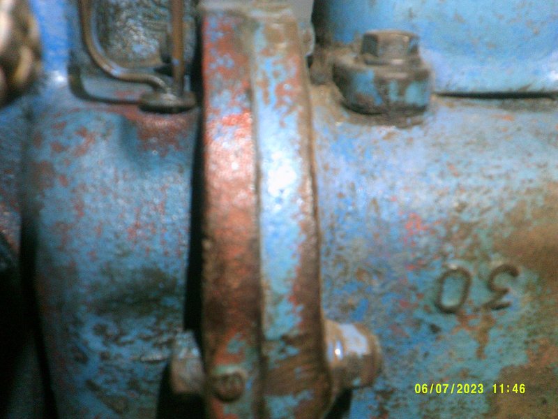

I'm pretty sure Super Billy is a Super 55, but herein lies the problem. As far as I know Ebro never stamped the ratio on any of their tractors, and although the Super 55 is said to have been made with the slow ratio only, as the 160 (and all later models and possibly the very last Super 55's as well as they ran out of parts for the NP gearbox as the 160 gearbox is even slower) was available with both ratios it means that anyone could have asked for a swap or even done it themselves (the pre NP PTO became available again with the 160 too as the gear ratio for the PTO was much slower). This of course means that without him running I can't tell what he actually has, and as Ford had been stamping the ratio for about a year before Ebro started making the Super 55 it's even stranger that they didn't stamp the ratio. Here's what you see in both places you expect to find the ratio:
Nothing here
The serial number extra location. Ebro put it here as well as in the usual spot under injector no. 1. After 70 or 72 they swapped the serial and engine number locations on the block, with the serial number now under injector no. 4.
Nothing here either. I'm afraid he's not that clean yet.
