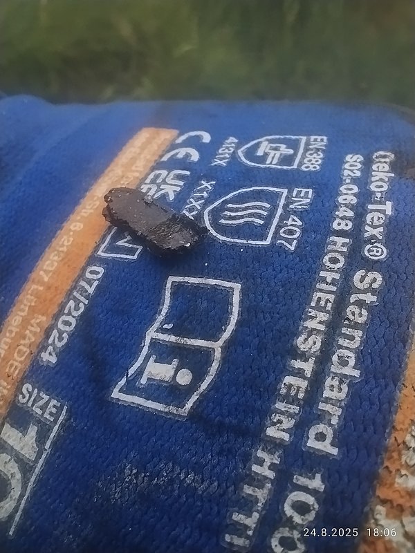

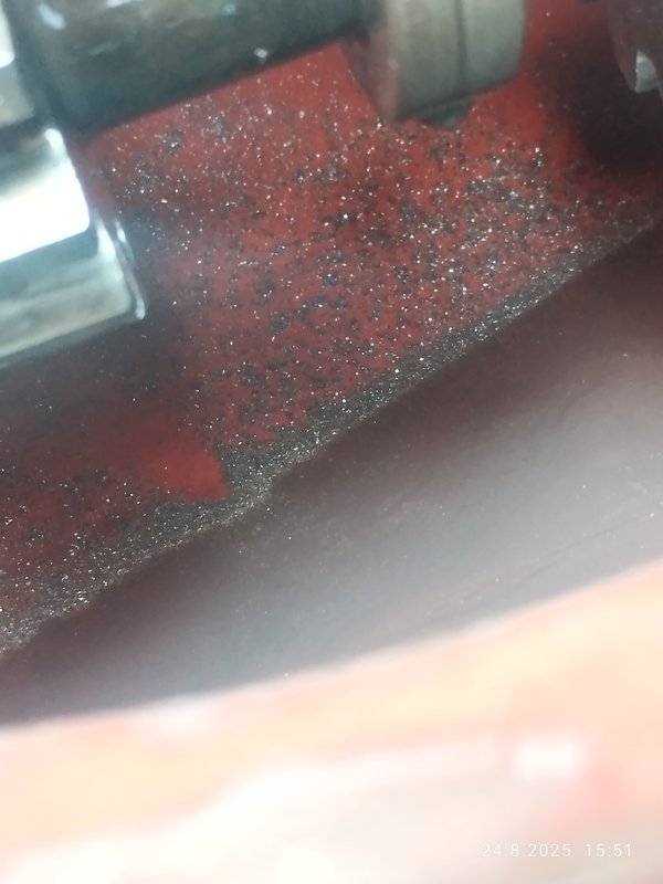

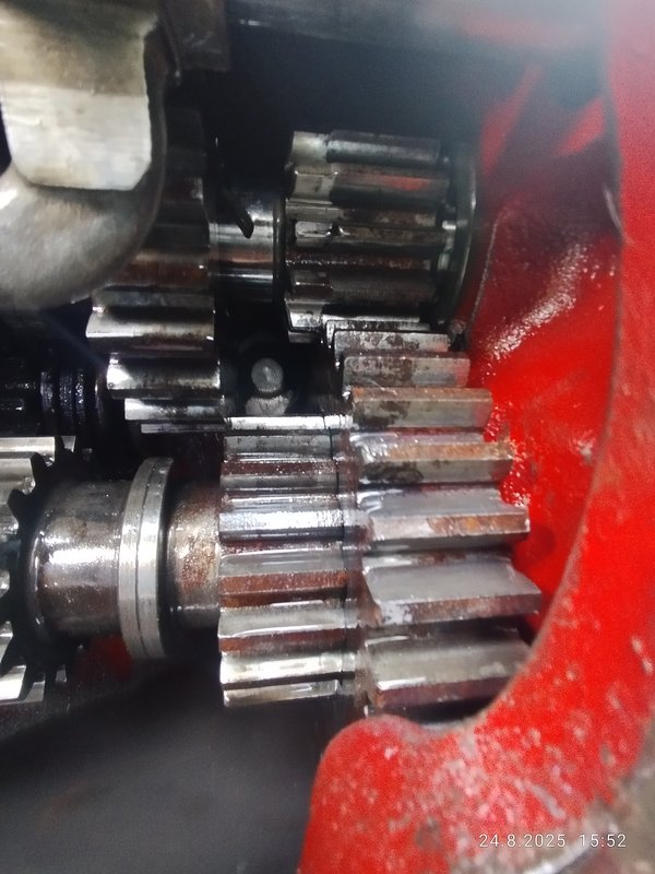

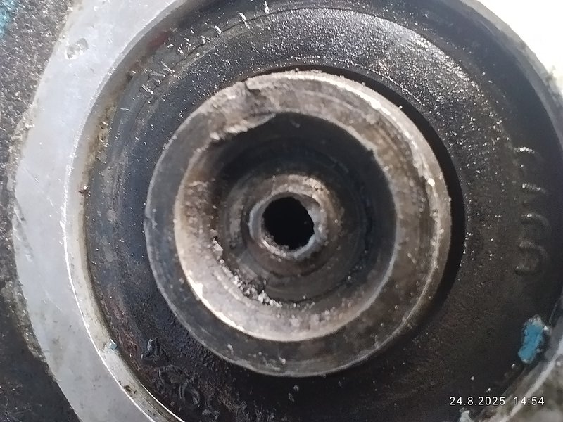

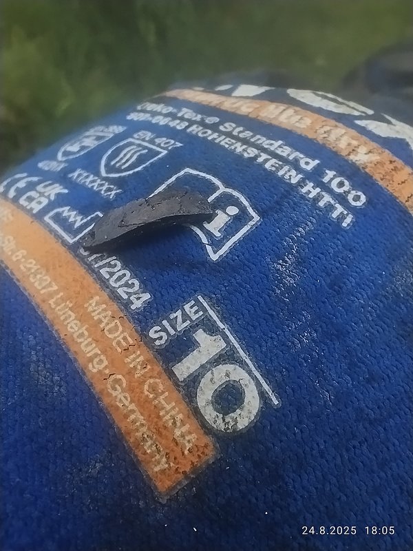

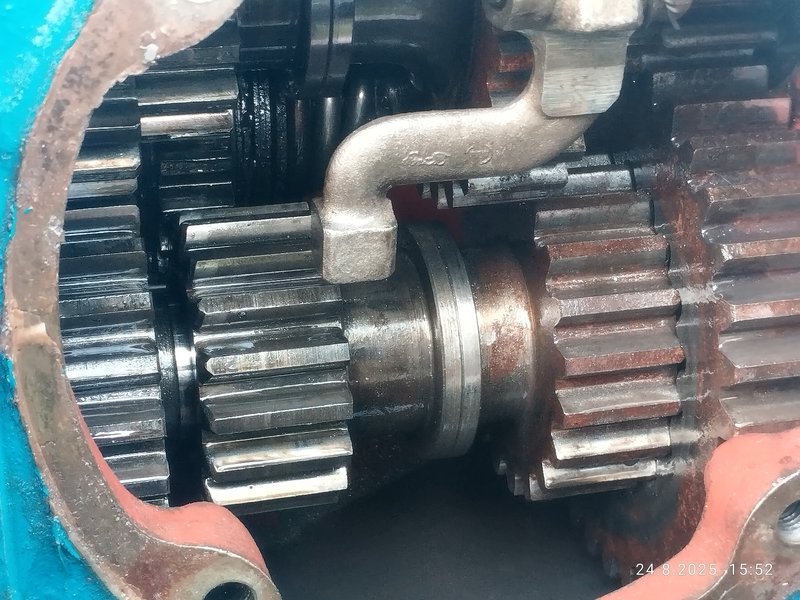

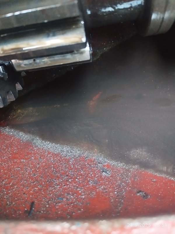

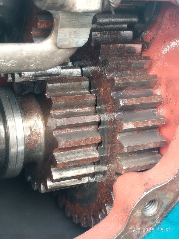

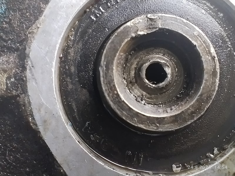

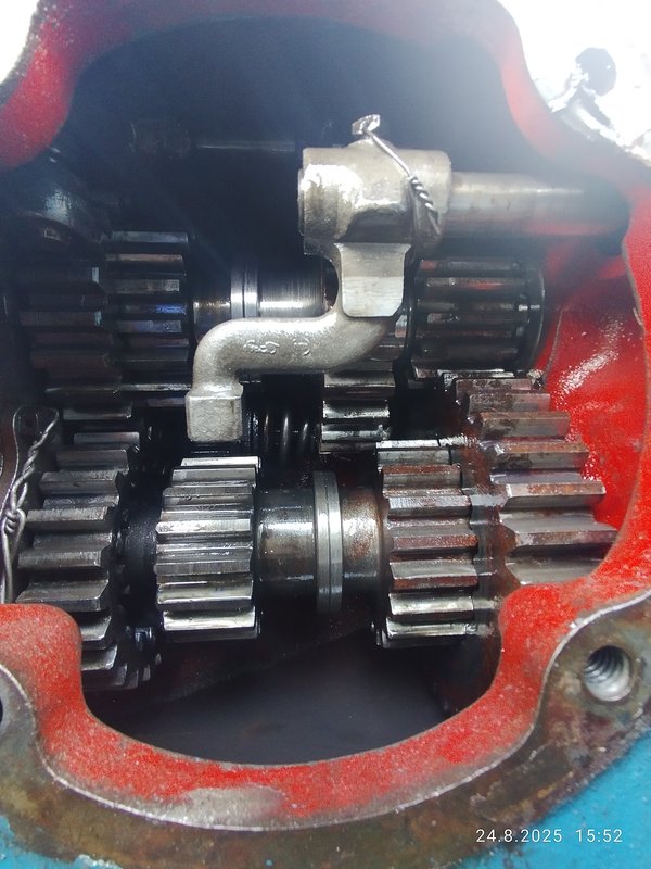

Hi guys today I disassembled and then reassembled the entire transmission I recently purchased. The transmission including the bearings looks to be in perfect condition. I then opened up the side section on the tractor to see if I could see any problem in the transmission that is currently in the tractor. I tried moving the gears to see if I could feel any play and visually checked the bearings but found nothing. Overall I think the problem is on the side where the PTO is located.But I found a large amount of metal particles in the other part but as I said visually I didn't see anything or I am blind but I will add some pictures here and maybe you more experienced people will see the problem right away.However, I hope to replace the gearbox in two weeks and find out more. I have one more question for you and that is about the speedometer cable and the minimac pump. Unfortunately my speedometer is not working and probably because the connector in the fuel pump is destroyed. Is there an in between piece and or does the square part of the cable stick right into the camshaft?The last two pictures are the fuel pump speedometer cable connector. Thanks a lot for the help

The short answer on the tachometer is new camshaft. A big job which requires full phasing and calibration. As for the PTO issue, the metal fragments are a concern, and you'll need to remove those before reassembly. The condition of several gears is a bit doubtful with rust perhaps contributing to trouble (but not significantly). Having said that, I don't think that is the problem, I still think you have a poor bearing somewhere, probably one of the ones that are more difficult to see without dismantling. After the swap you should see what's happening, hopefully find something in the gearbox you just removed. I recommend you strip it to check that and see what you find, possibly before reassembly, just in case.

Rather than replace the injection pump, there’s probably some type of metal filler available to build up the square drive. Make sure that neither cable nor instrument are seized before refitting.
When the tacho stopped working on a Super Major, I jammed small slivers of wood around the worn square as a temporary measure. It lasted for years.
Posts: 2334
Re: PTO problem? Gearbox noise Super major 1963
Davie has the same treatment but with metal, although it's the cable that's in trouble, and I'm hoping to get one some time. As for Ales' pump the squared part is actually broken off, which is why it most likely requires a new camshaft as I struggle to see an easy fix without damage. The squared part sticks out some 3/4" from the rear cover, the pics are with the adaptor removed showing the rear seal.
