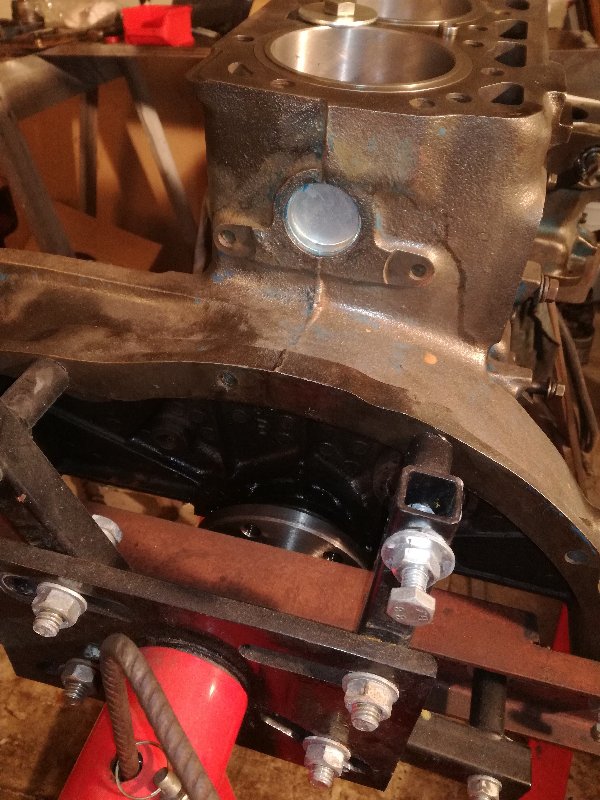

I put some scotch on the bolt, as I still need to torque it down. Wanted to put some loctite on it, but have to order.
I also put new core plugs in the water compartiment of the head and the block. I reused the plug at the back of the camshaft.

A little more progress:
The rocker shaft in pieces, so I could clean the inside. Needed to drill out one of the locking pins.
Found out I forgot a plug for the oil gallery behind the engine plate. So I had to do that part again.
So now I will check all the bits I've still laying around to see I've got everything. I hope I can find the bolts to fix the waterpump too :s
But all in all I'm happy with this progress.
