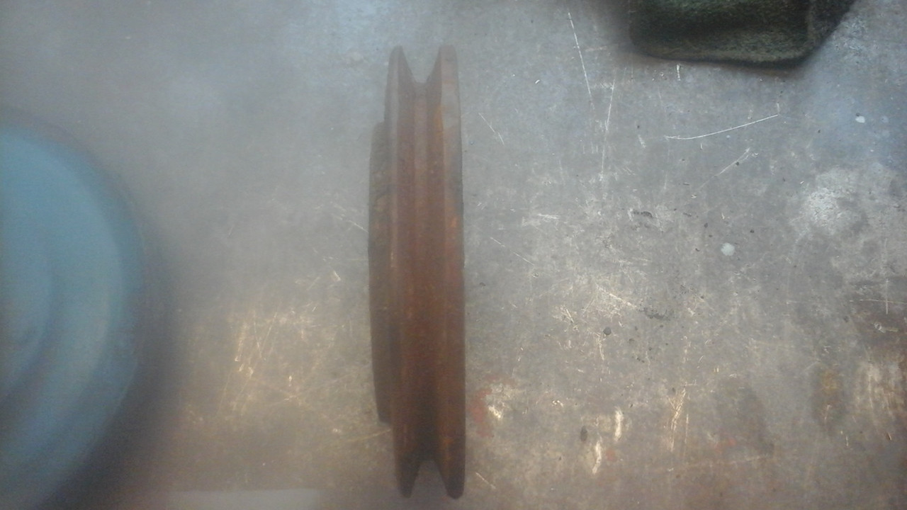

This is the pump drive pulley from a JCB 3C fordson engine that also drives the power steering pump. There are 6 countersunk holes on the back that locate over the rivets on the Major crank pulley to lock the 2 together, so from that i would say that the Major pulley would be strong enough as the pump pulley is driven from it and not keyed to the crank
