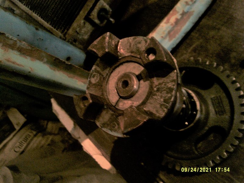

Re: How do you know if the engine is healthy?
Hi Adrian
What drive disc is on the injector pump?
Definatly a healthy sounding major in my opinion
The fibre one is the original one (and the good one I think).
Being a NP tractor it may have the multi-segmented one, which runs quieter than the earlier 4 segment one.
The eight segment one is rubber, the silent one; as far as I know only used by Ford on six cylinder engines, over here many people had these fitted to four cylinder engines as they didn't like the noise of the fibre one. Nowadays there are plastic versions that fit the fibre one, that are not worth using I think. I much prefer the fibre one, anything else sounds wrong to me.
The change to the type of injection pump drive coupling was a deliberate move to reduce the amount of "rattle" from the coupling, and happened some time after the introduction of the minimec pump on the 4 and 6 cylinder engines in 1962. Two types of 8 segmented drive discs were used, one was 12 mm thick and one was 25 mm thick. I suppose it' s a case of horses for courses, the 4 segment fibre one was the correct and original fitting for vacuum governed pumps, the 8 segment one for most minimec pumps.
I think I've seen more fibre couplings on 4 cylinder minimecs than rubber ones. We have both thicknesses of rubber couplings, but Super Billy has recovered the fibre one while reparing the injector pump (he had the thin one). I definitely think noise was also considered when getting the silent coupling. I can't say I've seen the early coupling on a 6 cylinder minimec though.
I thought I had a service letter that refers to the 8 segment drive disc, but not so. It did appear fairly late on in engine production, don't forget that the 6 cylinder 590E engine was continued to be assembled until 1967 and the 4 cylinder 592E engine until 1971, both in industrial specification and with industrial serial numbers. This was possible because casting of the heads had been transferred to Ford's Leamington foundry ( "FL" heads - "Ford Leamington") in late 1962/early 1963 and casting of the blocks had been farmed out to the Sterling Metals Foundry Ltd in March 1964, thus all castings were available from sources outside of the Dagenham foundry which was massively busy with castings for the new highly successful cars such as the Cortina, and with preparation for castings for the new 220, 330 and 360 " D" series truck engines and for the block and head castings for the new 6X tractors to he built at Basildon. Castings for other engines that were soon to be replaced were also transferred to the Leamingtoin foundry around 1962/1963 such as for the straight six petrol engines used in the Zephyr and Zodiac cars up to Mark 3 models and which were succeeded by the new V4 and V6 engines in the Mark 4 models.
Stuart Gibbard, in his Fordson Farming DVD, refers to a change in the injection pump coupling on the introduction of the Super Major that was designed to reduce the "rattle" from the pump. There was a change in April 1961 to the engine metal half of the coupling which occurred concurrent with the new timing gears, and the new auxiliary drive shaft (pump drive shaft) that had different machining and wider key grooves than the earlier shaft. However the same fibre 4 segment disc was used and I cannot see how the new half coupling could contribute to a reduction in "rattle", unless the wider keyways and stronger method of clamping the half coupling to the auxiliary drive shaft somehow helped with the issue.
The gap in the adjuster part was moved from opposite the key to around 150º ahead and the clamp bolt was replaced by an Allen screw (from 1599502, at the same time that the timing gears were widened), this was short lived (I would think it failed to reduce the rattle as they were hoping), the original gap position and clamp bolt returning in March 1962. The keyway appears to have been widened from 1599502 as well. I am well aware that production of industrial and lorry engines was quite different, and that the silent coupling may well have appeared on 4 cylinder engines during the October 1964 to 1971, certainly Ebro engines picked it up from 1967 with the introduction of the Ebro 160. As far as 6 cylinder engines go as I said before I can't remember seing a minimec without the silent coupling, but I have seen far less 6 cylinder engines, and there could well be some with the early coupling. I will post some pics of both adjusters later.

Here are the pics of all couplings:
The original one (Billy's one).
