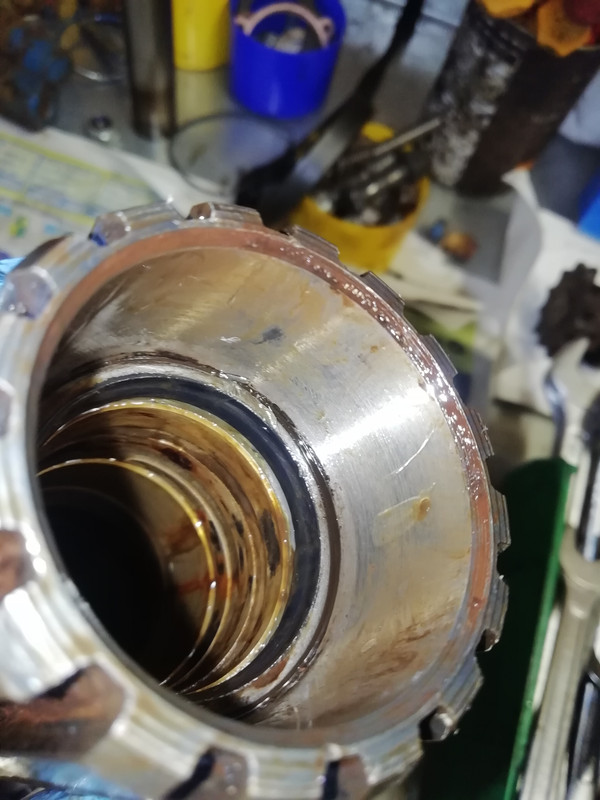

I've now had a closer look at this part, now I've cleaned it all up, and I think it might be the old type seal, unless I'm looking at the wrong thing?
It's a sequence of brass rings, at the front end (closest to the splines) of which is a grey - what feels like a hard metal ?steel - grey insert. I thought this was the rubber seal originally, but it's more like metal. Is this the original type that was subsequently substituted by the rubber seal in later builds?
Should I just leave it?

You have found the seal, part no. E1ADDN-7052A. I've seen the bit in the manual, you'll need something to pull it out with (don't disturb the bush inside behind the seal), and as for refitting you'll be fine as long as you fit it carefully and gently over the main input shaft splines. It would be better to have the fitting sleeve but it's not something worth looking around for for ages and if you were to find one it would probably be very expensive anyway. It's definitely worth replacing that seal now you've got this far.

I'm still confused by this assembly; this cannot be a seal, surely? The grey-coloured structure at the end sits less proud than the brass-coloured bit; it's also hard, not rubbery. It cannot be working as a seal. Or am I looking at totally the wrong thing?
This is the clutch end of the PTO to gearbox input shaft, looking down the shaft towards the gearbox; the main driveshaft off the clutch runs through the middle of here. Going by the workshop diagram (which is crap at best) there should be a seal here at the end of this housing.
Help!
Posts: 2435
Re: Fordson SM Clutch Play
The brass is the bush which appears to be ok. The seal is just ahead of it and it seems to be of the kind with a metal case, and if it's hard it definitely needs replacing, it's also pretty worn as it should indeed have a slightly smaller I/D than the bush.

TY - that's going to be a total mother to get out.
Posts: 2435
I wouldn't expect it to be very tight, and as soon as it gets out on one side it should come easily.
