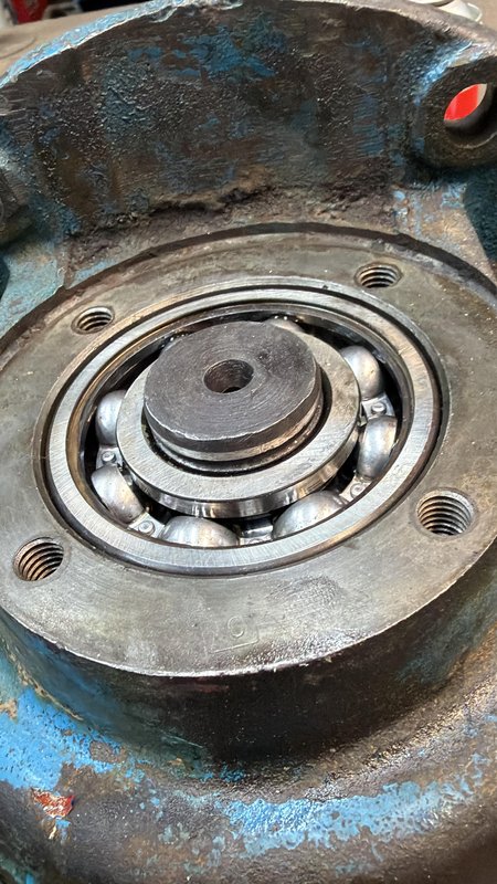

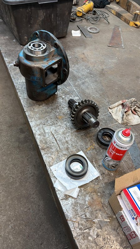

Hi, today I successfully replaced the bearings and seals in the PTO housing. Now all that's left is to wait for the needle bearings for the gear wheel. The needle bearings are supposed to arrive tomorrow, so hopefully I'll be able to start up the tractor and test it over the weekend. Aleš
Before applying the lock ring.
Posts: 2432
Re: PTO problem? Gearbox noise Super major 1963
Looking good. Hope it works correctly now.

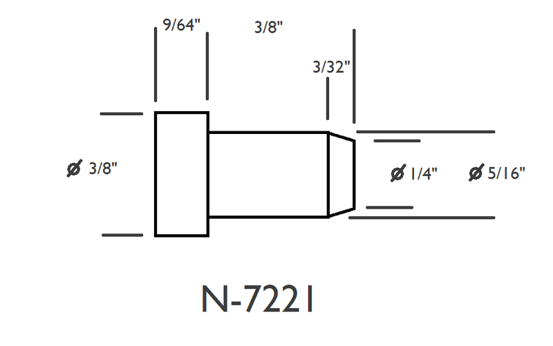

Hey guys, so over the weekend I replaced the gearbox and completely overhauled the PTO housing. I have to say, it was really hard work putting the two halves of the tractor back together again. It took me quite a while to get the shaft to fit into the clutch plates. For quite some time now, I've thought that there was a problem with the gear stick, namely that there was some play in it. I tightened all the screws connected to the gear stick, but then I noticed a screw inside the housing that has some play, but I don't know if that's normal. I would appreciate some advice. Thanks a lot, Aleš
https://youtube.com/shorts/0cKcv0XYT7A? ... 5jAQp828xd
Posts: 2432
That's not a screw, it's a dowel, part no. N-7221. These wear badly, the housing and lever do too. Not a big deal, and it can wait for a test run, I'll measure it tomorrow so you can make a new one and fill in the wear in the housing and lever, at a suitable moment. The ball on the end of the lever looks good, but you do get sloppyness there too. As already said, not an urgent job, and actually many aren't fixed and still work as sloppy as you can imagine, but you can take it up and feel it works better, even just replacing the dowel will make a big difference.

Posts: 2432
Just adding the sizes of N-7221.
