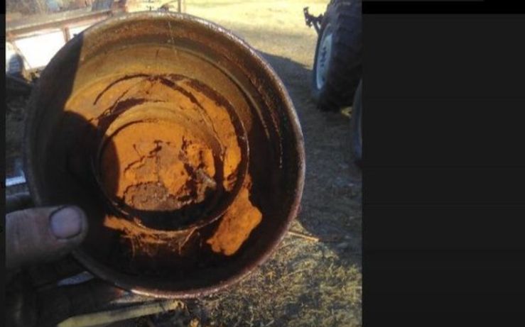

I assume the ring is critical in the design of the air cleaner?
There is a hole I'm confident could be taken care of but not so sure about that inner ring.

The numbers are fine, the pump number still has the B suffix from 1239515 which is there to confirm that the camshaft is not the original design used before 1239515 as that allowed the engine to run backwards, other than that the pump type number is the one that was used from a bit before Daisy till the Mk2. The Super should be 75S 647, and the pump number in the 300000 or even 400000 area. It moved down and back a bit, and I suspect these changes occurred either from 1299000 with the new excess fuel device or from pump 61994 when the plunger helix angle was changed from 45º to 50º. Hyacinth should be as later tractors but with the same inspection cover. That is more like an inner bowl, I'll get a pic of one of ours later, although they're full of oil. The Super should be helpful there. You need that to keep the oil relitively level so it cleans the air.

The burgess filter is different, but I can't help a lot more with that as we don't have one at the moment (Davie has a Burgess filter but the Dexta one is not a great one to use as a guide here, as Daisy has the second type Burgess filter still lacking the removable element). It will be very similar though.
