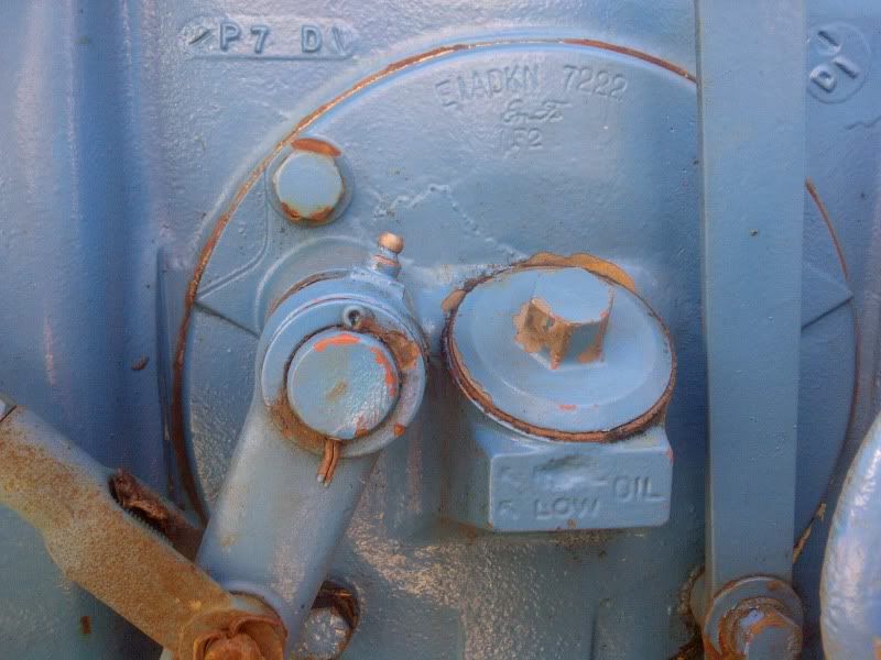

this is the one on the gear box, i read it as E1ADKN, Not sure what the second number is, looks like 7007

did you mean here, the first number up from the plug is 1F2.
this is the one near the lower link arm bracket....the one you cant see reads as M240..I think.

The casting on the transmission says 7 december 1960, and on rear axel its 24 october 1960, i asumed that the 0 was a D...
This could be an super were they used the last parts from the power major at the assembly, mayby brian could tell

First Super build on October 24 1960 has number 1575971. Build from half December 1960 until half January 1961. The wheels are from a New Major. The 3 hole wheels were introduced with the Power Major.
P7D is December 7 1960
M24D is October 1960. So your rear end is the first to be build on a Super.
