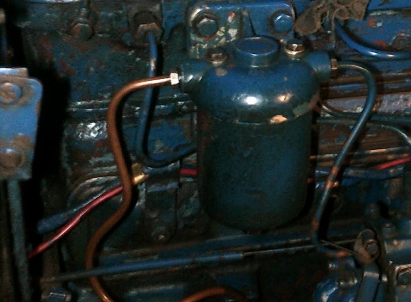

mine does also has an ebro engine:
on the other side EBRO is visible on the engine

I think the information from mathias1 answers the question posed by Philip, and it looks like he does have an Ebro engine in his roadless major. It also should have "Ebro" cast in the block on the starter side of the engine.
ALSO NOTE: the numbers on this Ebro engine are punched by a set of standard type number punches, whereas Ford used number punches that were more of an italic type with characters "on the slant".
If anyone has any further information on Ebro then please post it on this discussion!
