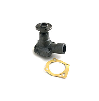

I got the pump off. It's partially seized up. I can turn it, but barely. The impellers on the pump actually seem to rub against the housing of the pump.
Now for the issue -- It seems that water pumps for Super Majors with power steering are not readily available.
This thread seems to indicate that someone had success putting their hub on a non-powersteering water pump, and it worked. Link http://www.yesterdaystractors.com/cgi-b ... n&th=19979
Also, I'm not terribly familiar with water pumps. But from what I've read, it seems you have to press the shaft out to put the hub and pulley on? I wasn't sure if that's true of all the repalcement pumps, or just the ones where you need to replace the pulley?
Here is my pump:
Here's the replacement pump that I bought.
And this thread seems to show the pump I actually need.
http://www.fordsontractorpages.nl/phpbb ... ley#p43033
Any better ideas?

Sounds like one of the impeller shaft bearings let go. It might be possible to get it rebuilt, but will likely involve a machine shop if you need a new shaft or the bearing seats turned.hobo13 wrote:I got the pump off. It's partially seized up. I can turn it, but barely. The impellers on the pump actually seem to rub against the housing of the pump.
Here is my pump:
Any better ideas?
The pump you ordered uses a different pulley cone that slides over the front of the hub. I'm not sure if there is any difference between the two pumps unless you can do a side-by-side comparison.

Sorry for the late reply. There is a water pump rebuild kit available that includes new shaft and bearings. See link.

Got your PM, you have a few choices, get a rebuild kit from agriline, silver fox, etc. And rebuild it yourself or have a shop do it for you, or you can buy a new/rebuilt pump and press the hubs off both and swap them. Be sure to measure the the distance from the end of the shaft to the hub on your old one so you get it in the same place during reasembly, if not the V belt may be misaligned with the crank and gen pullys.
