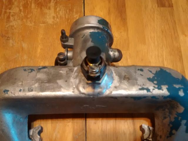

I did it to my '57 Major. It worked pretty good till I broke the flame heater. I don't have any pictures right now. I used a flame heater meant for a Massey Ferguson tractor. I got a guy to weld a 7/8th inch nut to my intake manifold so I could screw the heater into. Here's a video of another guy's Major with a intake heater.

It's been too cold for me to go take any pictures but I did find two on my phone.

Back to this thread, liking the look of the inlet manifold heater. Wonder how effective it is?
