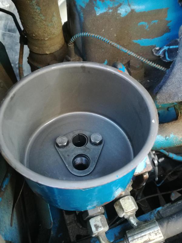

Cleaned up the reservoir
Put in a new filter also. It's the Baldwin P183 one
