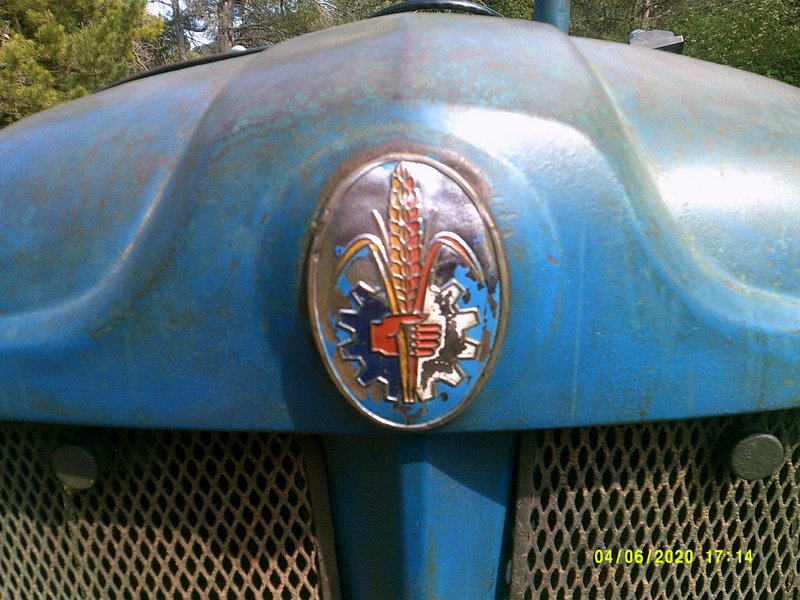

The instruction book is wrong, the colours up to 1957 were these (Billy's badge)
from 1957 to 1963 this is what the badge looked like (Davie's badge) (the words SUPER MAJOR were in black)
and all NP Fordson's had this (Super Billy's one, the same as the previous one but only NP grey rather than orange and black).

I got a new badge and it is slightly different to the original. Is it just the new ones are different or are there different versions of the original? Things like leaf thickness and corn husk shape. Or am I just too much of a perfectionist?
Posts: 2561
Re: FSM Nose Badge Colour Scheme
There are detail differences in the original ones depending on the period, but there are some very poor new ones around that look totally wrong, and I fear that's what you have just got. I would keep the original one but that's just me.
