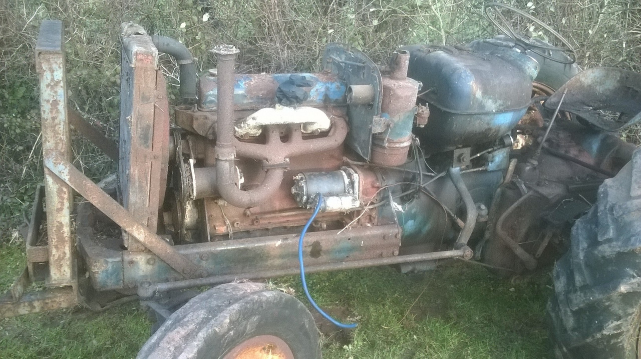

Managed to get this out of a hedge today, it was completely covered in brambles, part of a back wheel was visible if you looked hard enough, and took an hour with the hedge cutter and a 4wd Renault tractor to free it. It was running when it was parked there about 15 years ago but the great UK weather has taken it's toll. The engine is frozen up but may free off with some tlc, the tin work is gone and the rad is definitely not the right one. It was going to be scrapped so I thought i'd rescue it, not sure why. But the look on the wife's face when i got it home said it all, 'dear god not another one!'

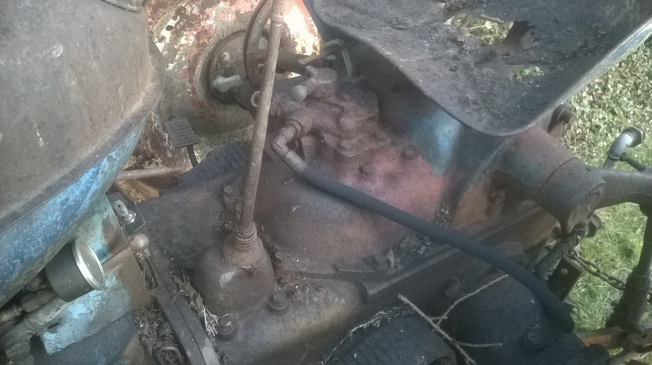

Nifty bit of plumbing between Dowty and Exactor couplings.
Fergy top link, possibly Nuffield drawbar.

From what was left of the bonnet I could just make out 'ground care and maintenance' painted on it so maybe it was used on a gang mower with separate rams?

Superb find John, looks like you've got a lot of work there. Several mixed parts too, the dynamo is the earliest kind. The LH brake is needing attention too.
I know exactly why you rescued it, and I would have too, you couldn't bear it being scrapped and decided to get it back to work. Seems like a special one too.

I did wonder about the number on the log book. I'll see what numbers i can find, as you say, a good clean will help! It's only got one correct rear wheel, the front wheels are wrong, 4 spoke not 3, and it has a through-the -bonnet exhaust elbow on it. Can't see any real evidence it ever had a loader on it (usual pitting on the side rails) although it has a nose guard and the exhaust is the loader type

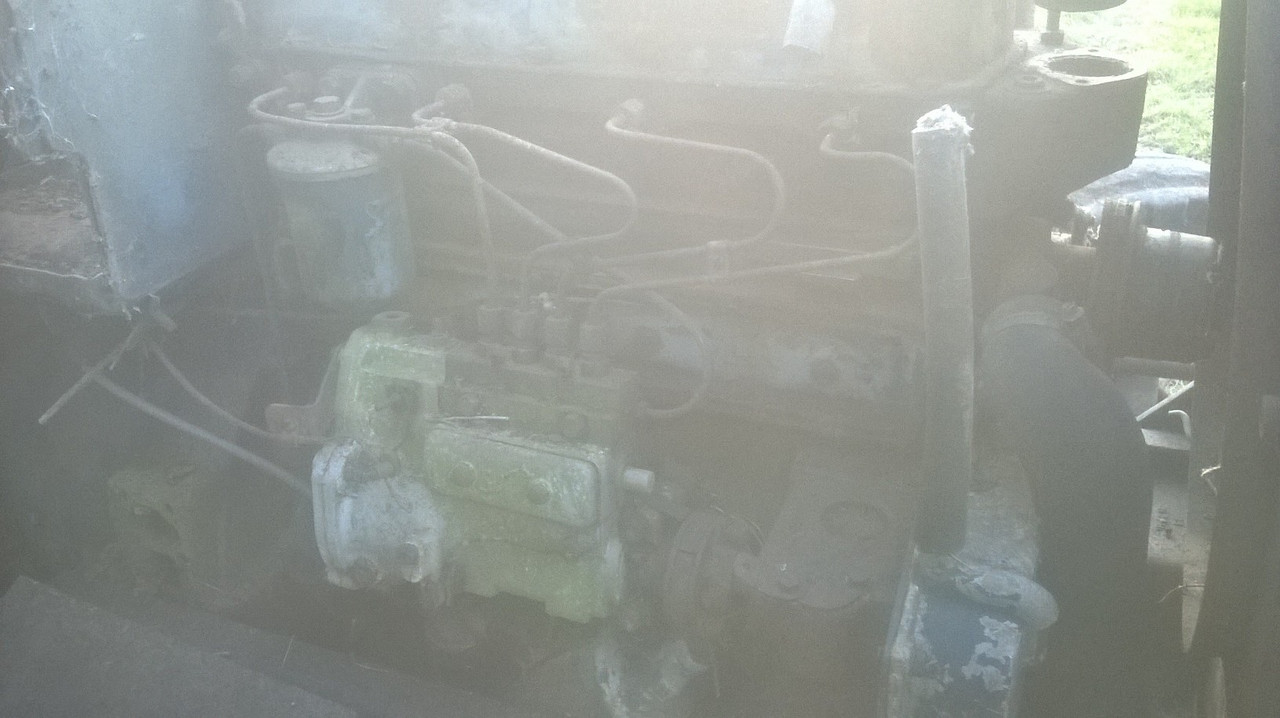

Quick update on Bramble, took the starter motor off and put a flat bar on the ring gear to see if there was any movement at all and it's completely free! Didn't turn it too far as i want to remove the injector pump first in case it's siezed up and i don't want to risk destroying it. I know the throttle and stop levers on the pump are definitely stuck solid but if i can free it all up and it's ok, i reckon a change of oil and filter, decent starter motor and a battery and she'll breathe fire again! It was a really good engine before it got parked up, spent years trying to get him to part with it and had just about given up hope until he decided to have a huge clear up, much to my wife's delight!!

If it is the original engine (IF!) then Sandy is right with his serial numbers, with a Minimec pump it is somewhere between April 1962 and May 1963.

Very good news John, hope the pump is fine. I understand the excitement of finding a free engine after 15 years, just shows how a well cared for engine will survive lots of things that are not great for it. It might be worth looking at the injectors while you're there.

Certainly wouldn't hurt to pull them out and put them on the tester. The only other worry i have is the liner seals, it has been stood with no water or antifreeze in it so the seals and grooves may have suffered

You should be ok, but to be on the safe side put something into the cooling system to see what happens.
