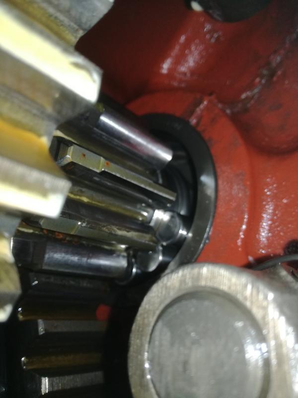

The bearing at the top is known to fail when there's not enough oil in gearbox. So first thing you can check is the oil level in the gearbox. It should be almost at te level of the filler plug. The oil level in the back is at a much lower level. If one of the 2 seals between gearbox and rear end is failing, the oil in the gearbox will flow to the rear end. I currently have this problem on one of my tractors.
If you have a small camera you can look into the filler cap and see the bearing from there. Or you can take of the side plate on the left.
Here you have a look inside one of my tractors (also a new performance) which also had a low oil level.
You can clearly see the missing bits in the bearing.
