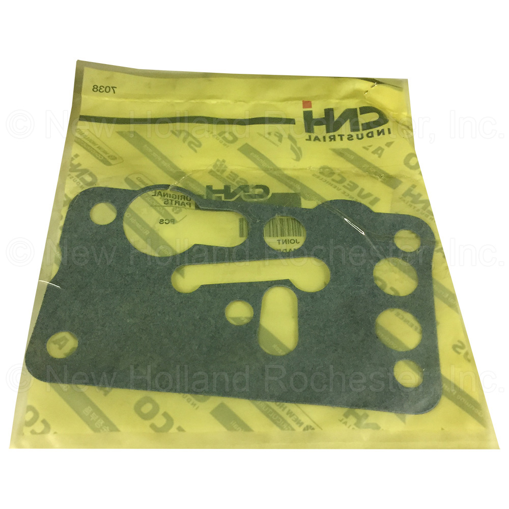

Not trying to dissapoint you but this is what the gasket is meant to be like.
https://www.newhollandrochester.com/wp- ... 189GF9.jpg
Before you lift the top cover (which by the way looks like a Ford casting as do the external service plate and the flow control valve) again look at the check valve if when you press the clutch and the implement sinks the gear lever seems to get stiffer and hold the sinking (not a common problem, but Davie has it and it's one of our pending jobs). And see if pulling out the external service valve holds the implement or not as that will help to locate the leak.

All Fordson plates have a gasket and o-rings. I didn't know the worldwide tractors were different in this sense, but as they were all new designs they would have reconsidered everything.
Re: Super Major low hydraulic pressure
Hi. Thanks for the photo of the gasket Sandy. I'd already realised it needs the hole under the flow rate channel from looking back at my photos. Will have another go at that tomorrow
It holds the cultivator up fine over night. Pulling the auxiliary knob out doesn't seem to effect it. I'm about to buy a spool block to control things I plan to run off the tractors hydraulics and the one I'm looking at has a built in relief valve so I'm considering connecting the spools to the hole on the RHS of the lid as this gives 180bar in draught control neutral position, unless there's a reason I shouldn't.
