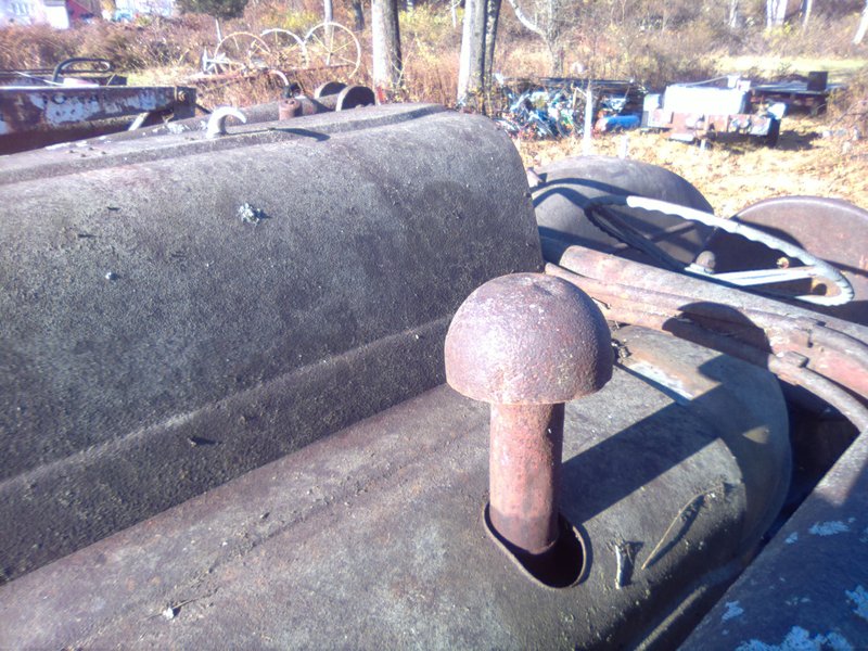

I don't think this picture shows how bad this shaft is rusted. Did not do much with the shaft. Spent time removing fenders and started removing loader.

I can't really see the rust, like the look of those radiator shutters. Those mudguards need serious work, and I can say from experience that you definitely want them. Repro ones are really bad and hellish expensive, and not having them is not great. Lots of welding there, it took us two months to fix Billy's one (posted about it at the time, viewtopic.php?f=2&t=8339).
