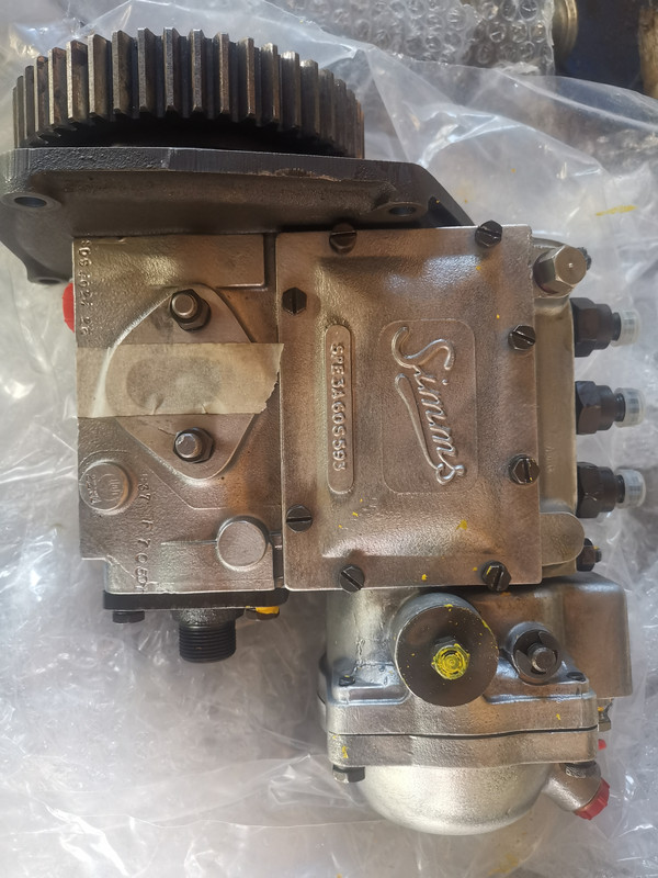

I found numbers engraved on the back of the pump. Not sure if that helps. I did not know to look at the inspection cover for number. My understanding hat been that there were two types, with gov. and minimec. I will look for that number. Meanwhile this is what i found on the back.

Changing delivery valves requires calibration, so better do it now if you're changing plungers already. Those two numbers I gave you are for pneumatically governed pumps, there are also two minimecs, P4588 for Dexta's (9.2 cc) and early Super Dexta's (11 cc) under Ford part no 957E-993101D, and P4696 for NP Super Dexta's (12 cc) under Ford part no 960E-993101. I've observed many stamped numbers on injector pumps but apart from pump serial numbers I haven't yet found out whart they are. Would like the pump serial numbers (on the cambox ahead of the lift pump flange) too. The outer races will be very tight too.

I agree, I don't believe a 693 exists. Have you managed to find the numbers and governor spring identification?

I found the number.
I decided to go with the new pump.
They gave me 100GBP off for sending in a second pump, plus i still have the 3 brand new pump elements, that i am sure i can sell for 30 each.
At that point if seems like the better option.
