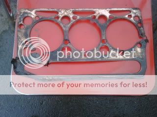

Well the man came today and the news is good, it's the cylinder head gasket that has blown in a couple of places. I was so relieved. We hope to fit the new one tomorrow, reassemble and fire her up again.
Gavin
Posts: 134
Joined: Thu Jul 08, 2010 10:30 am
Location: South Wales
Post by Gavin »
Well looking at that gasket it certainly explains the water leaking from the front of the engine and going into the sump.
