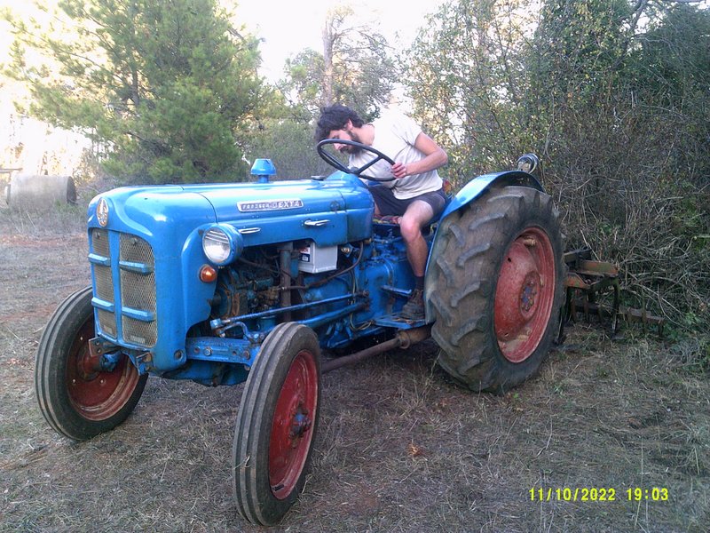

I have added photos to show the hole in the exhaust where the down pipe meets the silencer. Also a missing bolt filled with crud where the down pipe meets the exhaust manifold at the top.
https://drive.google.com/file/d/1CXzkaT ... share_link
https://drive.google.com/file/d/1Ca35bn ... share_link
This would be an easy fix. I am happy to get a new one and replace the down pipe and silencer. Unless there is a reason to prefer patching it up versus replacing.
Also added a photo showing a small crevice that stands out on the right side of the engine block seam behind the heating element. Is that anything to be concerned about?
Finally a video of me driving it in low second gear slowly. You can hear a distinct higher pitched rhythmic ringing which seems to come from the front fan assembly area. It sounds to me like the bearings for the water pump maybe? The previous owner suggested he thinks the water pump needs replacing and that the heating element doesn't work.
I will test the heating element to see if it glows red.
I wont remove the pump until I have tried replacing the radiator hoses, they are hard. The leaking of coolant seems to be coming from either the lower mid section of the hose which looks cracked on the underside. But also, The leaking seems to come from where the lower hose connects to the water pump housing?, will add a photo of that:

I would get the missing bolt but wouldn't worry about the leak at the pipe joint as that's typical, even brand new. That crevice is a bit of casting, so nothing to worry about. The pics suggest the water pump seal has gone, when you fix that you can also see if the bearing is ok or not (you can try to lift the pulley and see if there's play). The water pump is repairable provided you can use a press and puller.
Re: Buying a Dexta special? in france
Briefly run the engine without fan belt. If the squeaking disappears, it’s either the w/pump or Dynamo.

It is indeed negative earth (because the dynamo has been replaced with an alternator, which are only made for negative earth), so disconnect the negative lead first. There isn't anything on a normal Dexta to cause residual voltage, but modifications never make it easy to be sure if you don't know what has been fitted. A voltmeter isn't the best way to see that the heater is working, but if when you press the heater button the warning lights become slightly dimmer it means that there is current being used, with an ammeter you would see what amps are going through, but the best test is to see if it glows when you remove the filter (which by the way is a very good idea as many get very dirty from lack of cleaning) and you can then test the primer as well (remembering to open the manifold tap if there is one whenever you use the primer and closing it as soon as you're finished with it).
You've found the temp gauge location, that gauge you've ordered is a repro aimed at the Dexta but very poorly made, try and see if you can find one that looks more like the original one which should be a bit more reliable but a good second hand original one is the only really reliable way, but they're difficult to find and very expensive. The alternative is to repair the original one, that link I posted is very good about that, you will of course need something to plug the hole in the meantime so you can run the engine. The gauge itself is held in place by the chromed dash, and while you have that off you have a good excuse to lift the whole upper dash to check the steering oil level which is under the dash. The gauge is in ºF, but as long as the temperature is in the green you'll be fine, assuming the reading is accurate. While you have the coolant out (the block drain tap is under the fuel filter) loosen the fan belt and try to see how the water pump and alternator turn (don't turn the alternator the wrong way) and whether there's play or not, it's probably the water pump as a poor bearing very often ruins the seal, which is definitely leaking.
For starting I would have the throttle in a mid way position giving about 1000 to 1200 rpm no load speed (this will help the engine warm up a bit as it starts running and avoid one cylinder taking much longer to fire than the others), press the excess fuel button on the injector pump if the heater isn't making much of a difference or it's very cold and make sure the stop lever is fully forward before pressing the button to ensure max fuel delivery. Then use the heater and primer as mentioned earlier and the engine should start in less than 30 seconds. If you plan to run the engine in the polytunnel I would get an extension pipe to put on the exhaust so you can work more peacefully knowing that nearly all exhaust gases are going outside. Diesel engines produce far less CO than petrol, not that it's not dangerous but it's worth having in mind.
