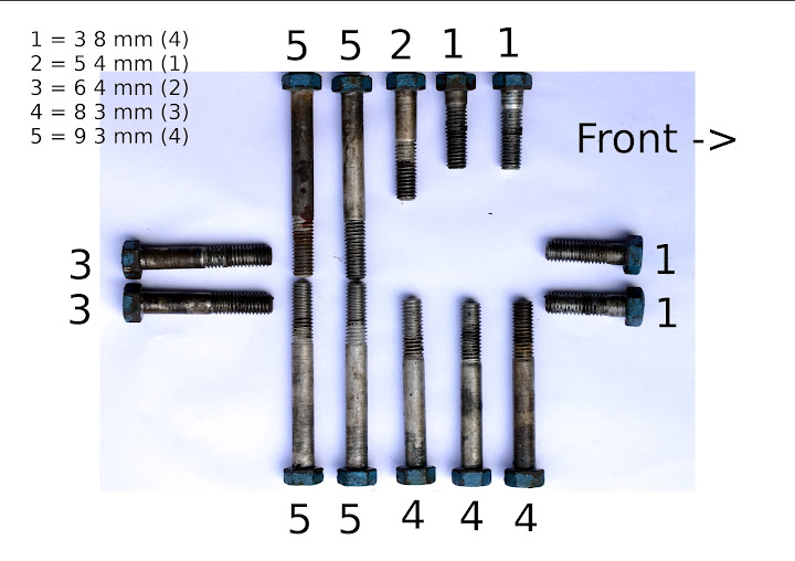

I noticed an error in the previous lay out picture of the lift cover screws. So I removed it, took a proper picture, redone the numbering and added the length of the screws now too. All measured in mm under the hexagon, so only the length of the narrow part - I thought this was more useful, because new screws can have other thickness hexagons. The number between brackets is the required number of screws.

Many thanks for the screw list it looks fine now
