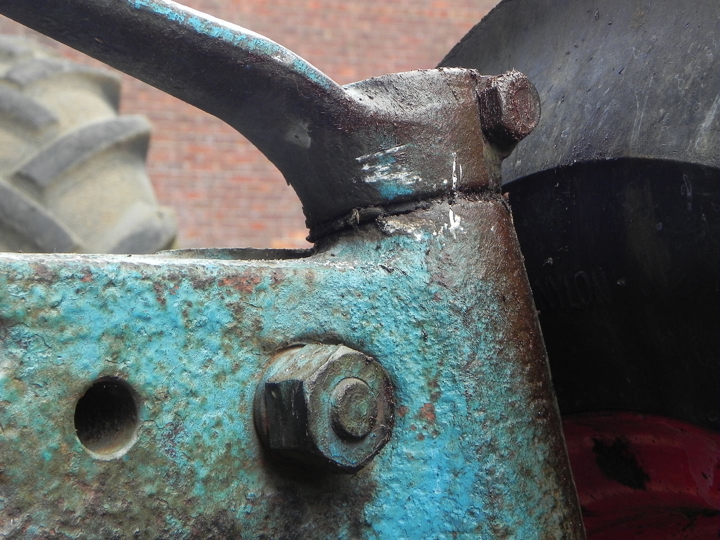

Dextas have a notch cut into the front of the stub axle and one on the steering arms on each side. Line the notches up in the straight ahead position and adjust drag links if needed, the job is done, no need to measure the toe-in.
You may need to scrape away a layer of paint and the marks can be quite hard to see, they are basically chisel cuts.

Re: Heavy steering
hi
I can find the marks on my king pin area , as in brians photo but I've never been able to spot them at the steering box end , anyone got a photo please ?
or are the marks only on the stub axle ends ??

Re: Heavy steering
I don't have a picture for you Tom, but on the steering rocker arm shaft there should be a line cut into the end of the threaded end, mine has 2 lines still not there yet but not sure which is the correct line, will see when I get to that point. Also on the steering drop arms you will find lines cut into the face of the arm where the washer and nut secures the arm to the shaft. The idea is to line those marks up and follow on with any finer adjustments using the steering rods, again that is what I shall be doing. Have you taken the drop arm off and checked the other side
Mervyn
Mervyn
Re: Heavy steering
thanks mervyn
each splined shaft has a cross scribed in it , and a line on the drop arm which I think / believe
I lined up correctly on re assembly of the box , id wondered if there is a mark between the box casting (were the seal is ) and the drop arm .
or are the marks only at the other end as I brians photo , think I may be over complicating things ??

Re: Heavy steering
There are no lines on the box casting. If you centre the steering wheel, at half the number of turns of steering wheel lock-to-lock, the drop arms should be in the same relative position to one another.Then align the front wheels with Brain's marks and fit the steering drag links, adjusting them to that length as required.tom lad wrote:thanks mervyn
each splined shaft has a cross scribed in it , and a line on the drop arm which I think / believeI lined up correctly on re assembly of the box , id wondered if there is a mark between the box casting (were the seal is ) and the drop arm .
my front ball joints need changing so I'll prob be wiser then .
Re: Heavy steering
thank you sirs
id miss read the manual originally then not read brians instructions correctly
my mistake
set them correctly today , both rods needed lengthening my about 1.5 "
thanx again.
