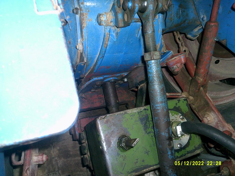

Attachment frame fitted. Three of the original bolts have been replaced with longer ones, one on the starter and two between the bell housing and gearbox.Three new bolts were fitted, two big ones on the adapter plate and one just below the footplate. You can also see the pin for the lifting ram offered up.
The pivoting frame inner part is fitted first, then the valve block bracket is offered up ready to be positioned once the whole thing is assembled.
This view is also pretty typical, but there are features that are different as a result of the homemade drawbar and the fact that he's a Narrow Dexta.
The rear end is now ready for the pump, note one check chain bracket bolt is out.
Pump fitted.
The bolt that was out holds the pump on.
Now with the feed and return hoses in position.
Valve block fitted.
Lifting ram fitted
Outer pivoting frame and mounting pad, and side ram fitted.
