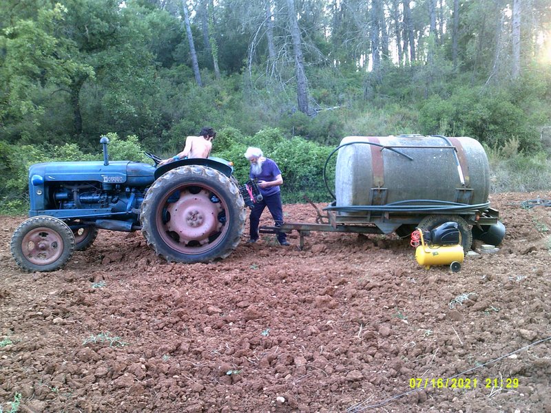

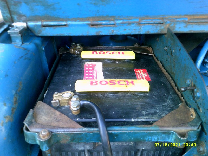

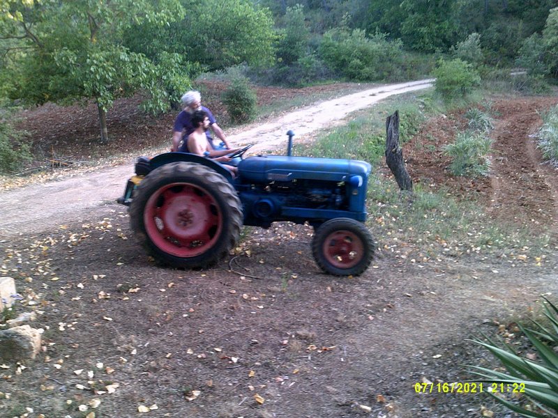

Here's the battery in, with the rare (I think, this is the only one I know of except another one which we also have for Super Billy) battery clamp tightened down. One of the rods is lost but I think it's here hiding somewhere. The battery is performing very well considering its age (25+ years old).
And here it is as we get the tank out of the garden, the LH tank wheel needing a puncture repair soon.

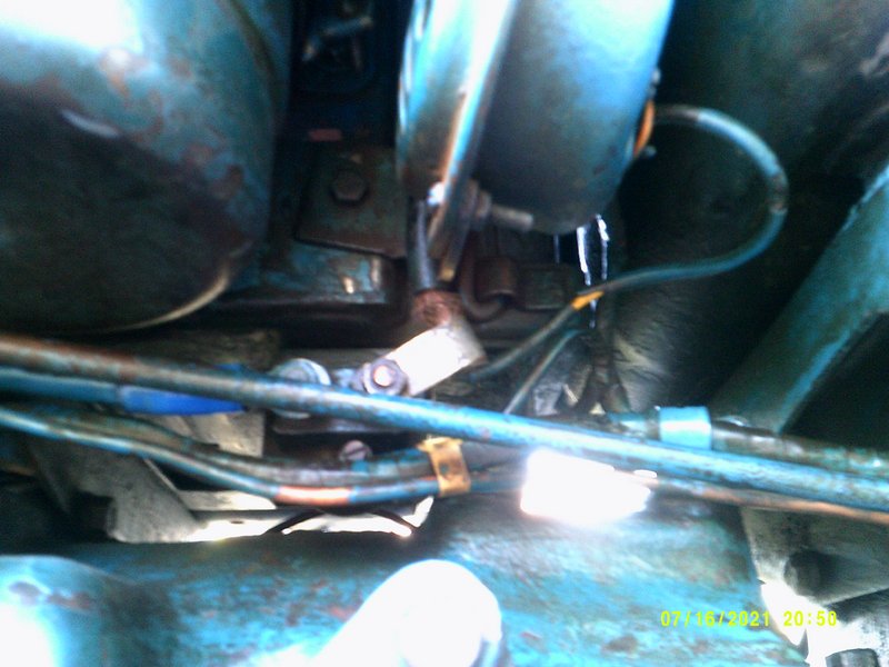

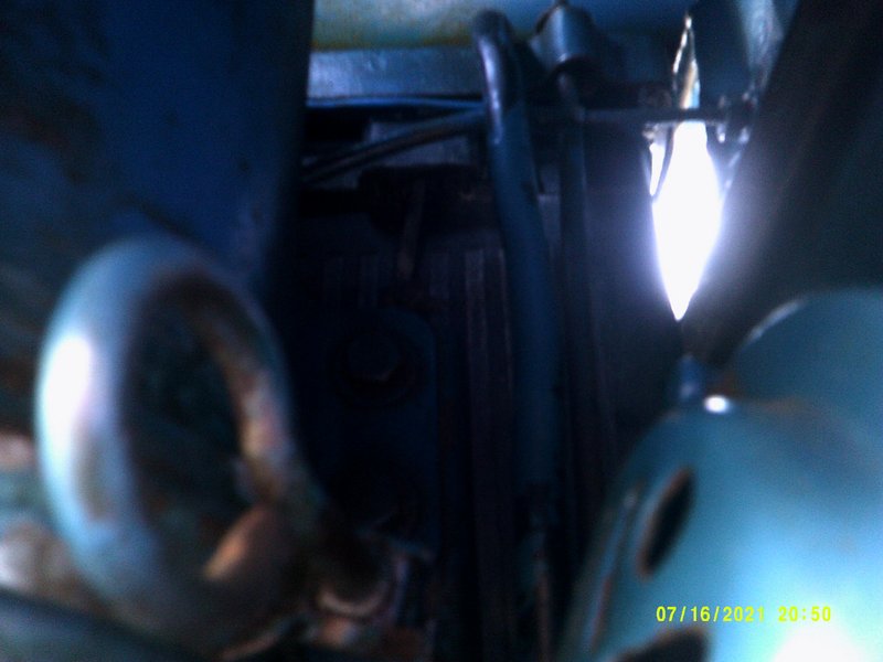

Hi Sandy, are the rubber injector seals leaking on Billy? I noticed the bits of rag tied round them
Posts: 2306
Re: Recovering old batteries
Yes they are, but not much and only after running. We might do something about it, but it's not alarming, it helps to keep him clean with those rags but not much more.

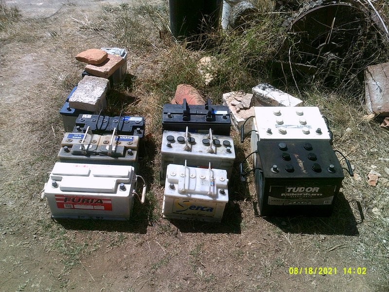

Just a quick update.
All of the batteries here
have been on the charger, only the old one that Billy's using now (the oldest one of all) and the Renault 4 one on the left (this one hasn't had the powerful charger on it yet) have been close to doing something on the test with the Hurricane starter.
Additionally, all our other batteries are out, awaiting charging, charging or awaiting more drastic action.
This battery on charge now started at -0.6V! It's never been used, our neighbour had it and was going to dispose of it but I thought we should try it as it's brand new.
The next step will be a good clean and new electrolyte with Epsom salts to see if something will come from this, we'll need distilled water for that, and we're quite short of normal water at the moment, so we won't be doing this for a while yet.
