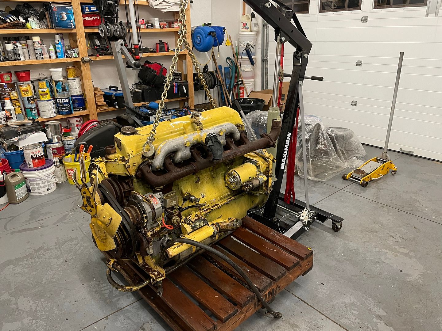

Doner engine 2715E from a New Holland 1400 combine.

Was really hoping this was going to be a simple engine swap. Unfortunately discovered a leaking rear main seal.
Leaking rear main.
Onto the engine stand it goes for further inspection.
Pulled the rear main cap off to replace the seal and noticed the wear on the bearing. Might as well install new main bearings while its apart.
And this is where I am at as of today: After inspecting the cylinder liners from below I noticed some slight rusting on the liners from the where the piston rings have been sitting in position for the last ~18 years. After alot of back and forth, I have decided to pull the head and remove the pistons for further inspection. Will probably (at minimum) install new piston rings and re-hone the liners.
Currently waiting on part availability confirmation. Difficult and expensive to get parts to Canada. Lots of these parts are readily available in the UK but shipping to Canada is expensive. Found a supplier in the USA, just waiting on confirmation. Alot of these engines are used in marine applications and seem to be readily available especially near the coastal regions.
Any comments are welcome, feedback is appreciated.
