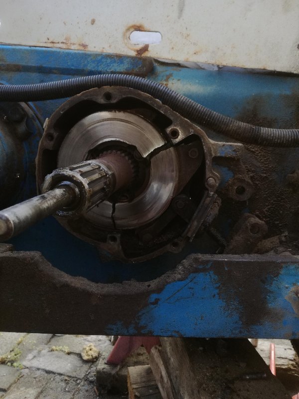

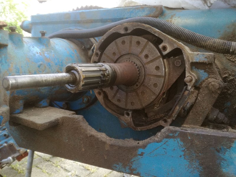

Well been busy doing some work on the Super 4.
So found a surprise:
(This is the diff lock side, the axle's are a bit longer and different on the county, since the front wheel drive starts from these. Except for the dirt, all looking well so far. I expected to have some oil in here, since the oil in the bevelhousing was a bit dirty.
never thought this would be the problem.

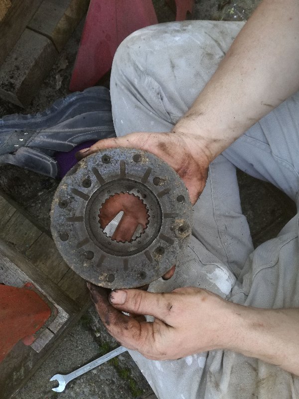

This brake disc doesn't look great either.
So this means I will have to source a new brake actuator, maybe put a new one on the other side (that I already refurbished..)
