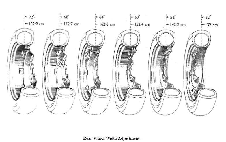

You can adjust the wheel track, you need to change the relative position of the centre and rim, you seem to be on almost max track, assuming you have std wheels (11-36 or the rare 11-38). If you have 14-30 wheels there isn't any adjustment.
Re: Super Major rear wheel adjustment
If you have the adjustable wheels like Sandy says, these are the possible wheel track:
72" 182,9cm
68" 172,7cm
64" 162,6cm
60" 152,4cm
56" 142,2cm
52" 132 cm
Posts: 2561
I meant to find this diagram but I couldn't remember where I had it. I see you're using attachments Mathias.
