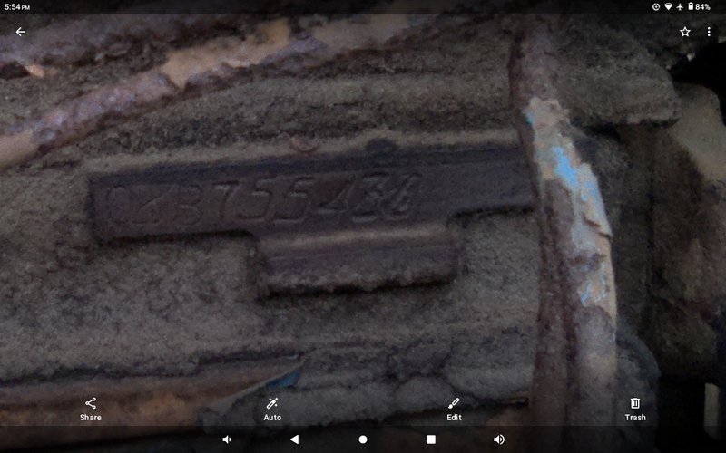

Is this the serial number for the tractor or just the engine?

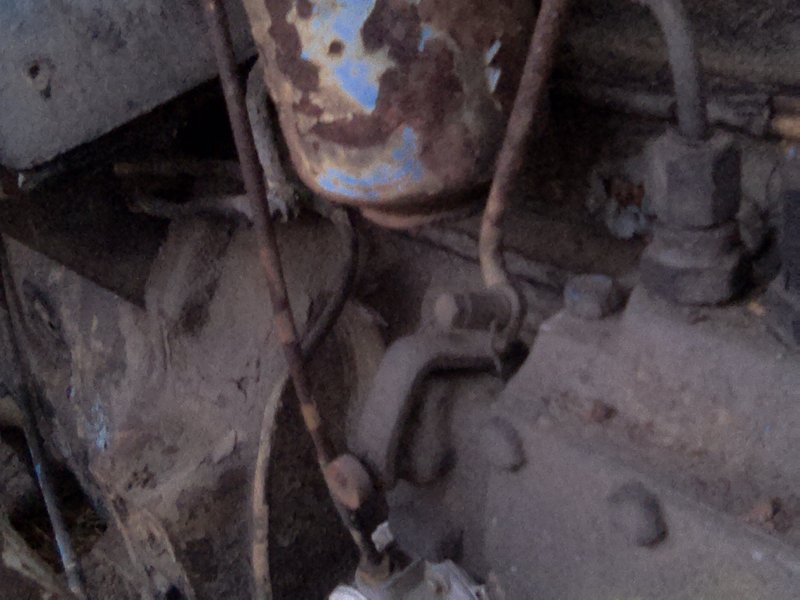

As you can see in one picture, the control lever is bent. Probably the least of the issues but any thoughts on straightening it?

That is the serial number (engines were only different if replaced, Ebro had a separate engine number but it was in addition to the serial number), April 62, one of the last before the minimec. The numbers were changed in November 61 . The stop lever is not easy to work on, probably easiest to remove the casing and lever so you can work on it more easily, as usual with injection stuff keep it as clean as possible. The lever is brazed onto the shaft, which can be a weak point (never known of it happening on a stop lever but have had issues with throttle parts that were brazed in a similar way). Is it still stuck?

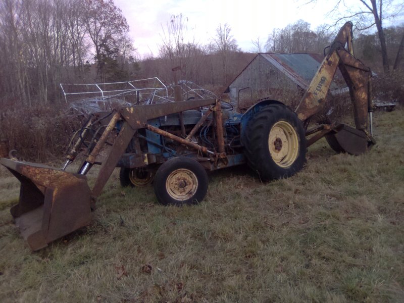

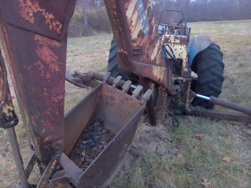

Knowing this is putting the cart before the horse here: What is everyone's opinion on what to do with the backhoe and loader if we end up getting her running?
Originally my plan was to remove them. We have a Ford 2120 with a backhoe and loader. But I suspect if the Super runs it may be stronger.
The 2120 is probably faster but is lighter for sure.
If we did decide to remove the backhoe and loader is it feasible to turn it back to a tractor with lift arms and hydraulics?

I recommend you fix the stop lever first, it will allow you to oil the rack at the stop casing end from outside. From 1613500 till 08B-756398 the lift pump was as you have, yours is totally original. I would keep the extras on, it will have far more power available. It's perfectly possible to fit hydraulics but it depends on what you already have fitted as you might need lots of parts.

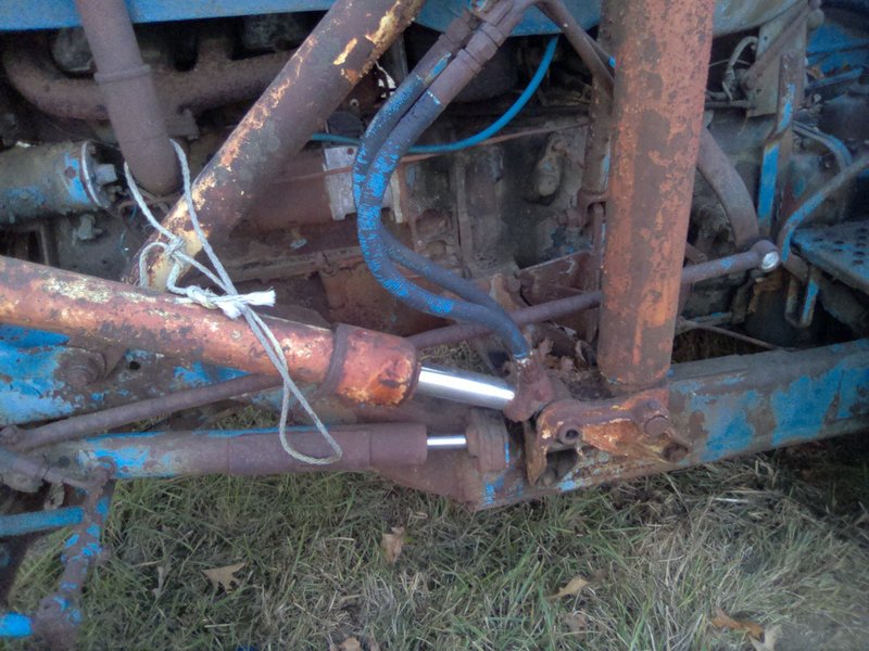

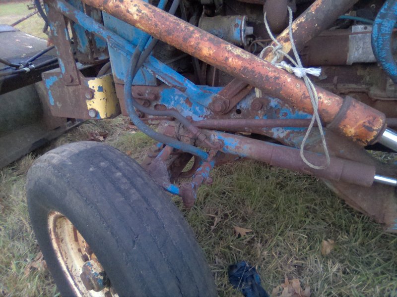

The only picture today is for the question of servicing brakes. I think I can swing the floor plates out of the way. Guessing at least one side is seized.

If there's ATF in there the seals could well be in trouble, Ford were very clear about using SAE 10W to 10ºF, SAE 5W for consistently colder, not power steering fluid or any other hydraulic oil. Start with a flush before trying to use it. The exhaust stuck in the elbow doesn't sound great, this is about the only place you could use heat on without ruining everything (as it gets hot when running anyway, don't let it cool too quickly though). Pitty about the bonnet, hope it's not too bad. Our half Super Major one split in half from seizure, although it had other issues too. Access to the brakes would be ok with removing the footplates on an ordinary Super Major (but not brilliant) but it looks like you have a frame right in the way. If a disc is seized on you'll need a very big puller to shift it.
