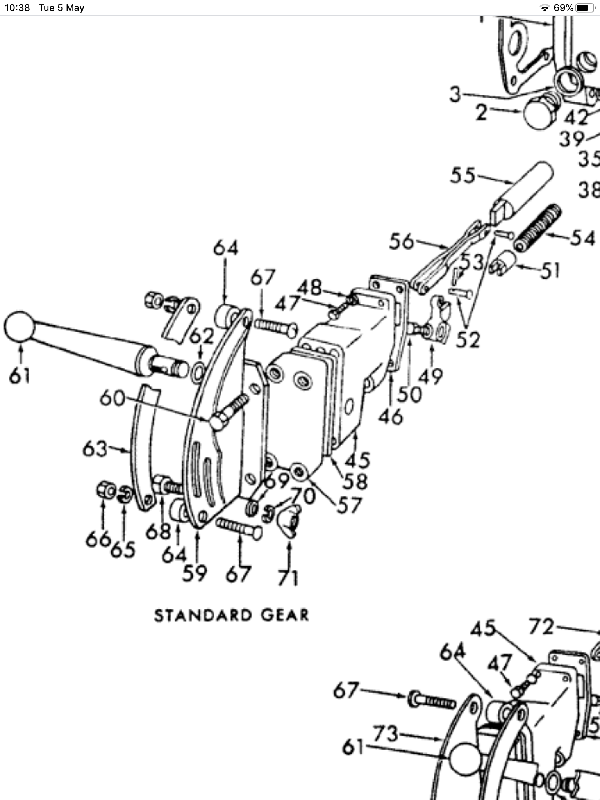

1. I have a leak from the pivot for the hydraulic control arm under the seat. I’ve taken it apart and the pivot only has one o-ring slot, and the pivot doesn’t come flush with the front of the housing. I’m assuming that a previous owner has botched this somehow as I thought the pivot had two o-rings, one in either side of the housing?

For leak 1. The spare parts list for the hydraulic valve chest states 3 0-rings for the hydraulic control valve and 5 when an auxilliary valve is mounted. Only one O-ring is shown on the drawing, or two with the auxiliary valve. Can't find the other O-rings but I assume you're right and at least two should be fitted on the shaft of the lever.
Part no. is 116516-ES and it is calles Seal (H.P.L. valve gear oil passage)-7/16" I.D. rubber. Used from 52 up to #157885. Also up to the last power major.

I would post a photo of the hydraulic lever, but it’s absolutely pouring here today and I don’t have anywhere undercover to work (yet!). According to the exploded diagrams it looks like there should be 2 o-rings, interesting that Emiel has found information stating 3, so I think one of my jobs today is to look into this further and check I am looking at the correct diagrams....

With regard to the hydraulic lever, I’ve looked at the diagrams from the NH parts list, and it states only one O-ring (no. 62). My problem is that I have oil weeping from the pivot hole above where the number 45 is- has anyone else encountered this? It’s the leak that is causing me most frustration!!

And thank you Emiel for the parts list and detailed diagrams :D
