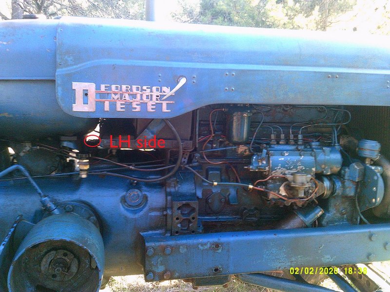

The original breather bolt is here,
it has a longer head than normal.
They almost always get blocked, remove it and clean it, keeping it clean is the only way to avoid it getting blocked. If it's not there do it as Emiel says.
