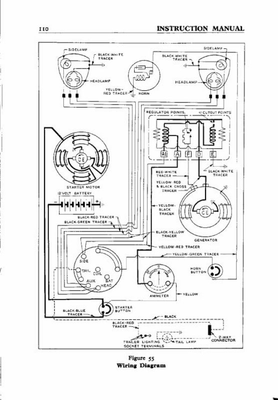

I'm looking for a wiring diagram for control box on E27N with Perkins P6. Also any information on the fuse box (size of fuse or how to prepare the original fuse). Thanks.

Don’t have a diagram for you, but if I were you I would take the diagram from a new major or dexta and use that to wire the charging system correctly. Wiring the starter and ignition switch shouldn’t be very difficult without a diagram. If I remember correctly for the e27n there is not a seperate starter solenoid. So just big wire from live terminal to starter, normal wire to ignition switch, wire to starter button and from button back to solenoid terminal on starter.

I don't know if the wiring was very different between the spark ignition and P6 E27N's (it is actually a bit different, different to a Major and Dexta too), but the spark ignition diagram is in the instruction book in the FFCN: https://www.fordsontractorpages.nl/ffcn ... manual.pdf
I'll post the diagram here anyway so you don't have to look for it:
Having said that I've just found the P6 one:

I had the gas version. Was P6 I was looking for. After posting this message last night I found the P6 diagram on the pdfmanual4trucks.com. I'd been looking for a couple of weeks and don't recall that web site coming up until last night (actually early this morning).
