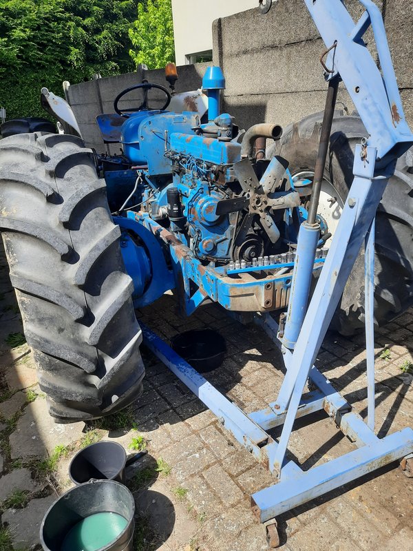

I had a busy day today taking out the engine of the super 4. I ordered the new live drive clutch to have it installed.
I also wanted to change the oil seals of the gearbox shaft.
Not an easy job :s

Luckily you have a nice and steady lift for your engine.
Curious to hear your experiences with the new clutch, assuming it’s the modern type.

Well the brick pavers are a bit a pain in the ass to move the engine crane.

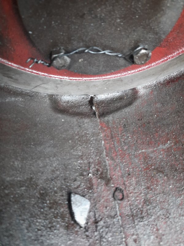

Good stuff, that clutch doesn't look that bad. Pretty clean bell housintg too.
Keep at it, the seals shouldn't be too owkward.

I've done the seals this evening.
Old ones were not that soft anymore.
Had to wiggle a bit to get the shaft out. Oil is still in the gearbox. Seems like the level of the oil is about the same as the shaft.
old seals out, new ones in.
I'm still waiting for the bearings to arrive, hope to continue soon.

Looking good. Yes the oil level is the same level as the bottom of the input shaft hole, we saw it fixing Super Billy's new seal. There is no need to drain any oil to replace the input shaft seal or gasket.
No need for draining the oil, is really a relief. with the underbeam of the county it's a messy job.
I won't change the gaskets, because that means a lot of work.
At the moment there is no oil coming out of this place.

We didn't change the gasket either and it's still dry. Oil changes must be pretty messy with that huge frame in the way!
