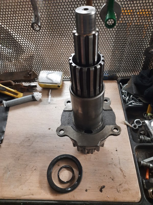

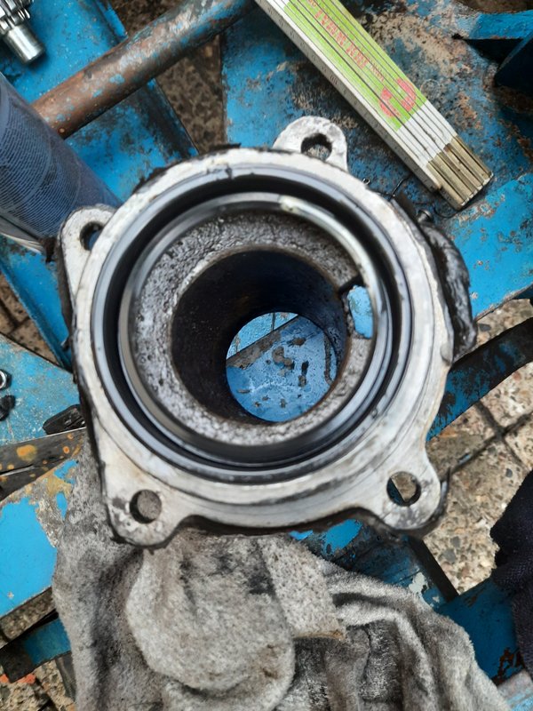

I've done the seals this evening.
Old ones were not that soft anymore.
Had to wiggle a bit to get the shaft out. Oil is still in the gearbox. Seems like the level of the oil is about the same as the shaft.
old seals out, new ones in.
I'm still waiting for the bearings to arrive, hope to continue soon.
Posts: 2559
Re: changing clutch
Looking good. Yes the oil level is the same level as the bottom of the input shaft hole, we saw it fixing Super Billy's new seal. There is no need to drain any oil to replace the input shaft seal or gasket.
No need for draining the oil, is really a relief. with the underbeam of the county it's a messy job.
I won't change the gaskets, because that means a lot of work.
At the moment there is no oil coming out of this place.
