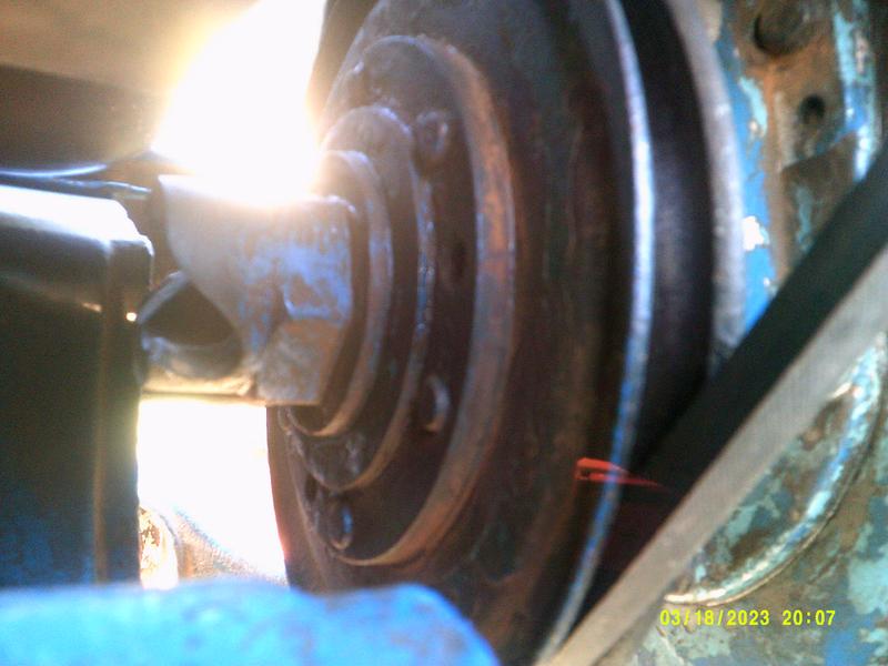

Alright,
The nose cone, rad, fan, alternator (new pulley done today), and front hydraulic drive components are disassembled...
Pictures ➡️ https://www.amazon.ca/photos/share/G34t ... bf3jPILvdT
A few things I need answered:
1) Is that the correct crank pulley for a 1952 Fordson Major Gasoline?
I am guessing that they drilled and tapped two extra holes for the front hydraulic drive. 🤔
2) If you look closely at the engines, main, front cover you can see one spot on each side of the plate (one under the cover and one under the alternator bracket) that have ALSO been welded! 🤬
PLEASE tell me that someone added locating pins in those spots, and that those are not BROKEN BOLTS that they welded the cover to!!! 😫
3) The belt that was on it was 45" and seemed to be the "correct" size (meaning not too much adjustment left in either direction)...so what's up with that!? Replacement belt (for now) is 44".
4) Best way to remove the 1 7/8" bolt (looks like a big bolt, not a nut as there are no visible threads or separation?) on the pulley?
I have the tractor in 5-6 H and the brakes locked on (the brakes work decently) and it still wants to turn the wheels, not the bolt...
Thanks!
Posts: 2529
Re: Timing cover AND other questions. 1952 Gas Major
There's no spec on compression, the ratio is 5.5 to 1, and given that diesel usually needs 300 psi minimum and the diesel has 16 to 1, about 100 psi is a bare minimum. These are general minimums, and not official, so not a clear cut line. Ford never did compression tests, they generally preferred to measure parts directly. All three engines had the same pulley, it was the pointers that were different. I would agree with the extra holes being modified, as you can see a cast part number for the pulley hub. The new holes are those in line with the rivets. Looks like the plate has been modified with homemade dowels, the early plates didn't have dowels, and particularly with loaders they would move and leak. dowels and an extra bolt were added in 53. Your plate appears to be a later one, for it has the hole for the extra bolt, but only one dowel appears to be close to the correct location. Your dowels also look like they're 1/4", the original ones are 1/2" in the block and plate, only 1/4" for the timing cover. The belt adjustment should start as close to the engine as possible, that will give the longest belt life. Correct size belts are quite tight to fit. There was a spanner for it (TTr/D 6319, later CT.6) but any 1 13/16" socket will do fine. push the brakes on harder to loosen it, you might need to adjust them. Originally the bolt had rachets for the starting handle which yours would have come with.
