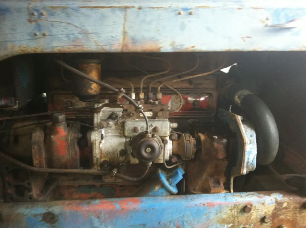

I've just purchased a New Major Diesel with the intention of a working resoration but am having trouble identifying the engine. The castings on the tractor indicate a September 1953 build (L1U near the clutch and L4U under the seat)
The engine however has a casting marks E1ADDN-6015-G on the block and E1ADDN-6050 on the head. Above the diesel pump the hand stamped engine number is 624EB1321 and above the dynamo is the cast into the block is the number D27H which seems to indicate something like a 1940's engine?
Any help would be gratefully received.

I think you have a replacement engine. The engine number tells me nothing, but if we could use the same code it would be a April 1962 engine.
Do you have pictures of both sides of the engine?

hopefully this will have the engine photos you asked for

Hi
That engine looks like it may have come from a truck as it looks like it has another pump bolted to the rear of the fuel pump which could be part of the truck brake system. That's why the stamped engine number doesn't make sense as they ran a different number sequence to the tractors, we do have some truck experts on the forum so they may be able to help you more on the engine. The tractor looks about right for the dates you have on casting codes with what i can see in the picture. If it is a truck motor it will have a few more hp than a standard tractor from 1953 as the trucks had a special intake manifold fitted if it's still on there, and adjustments to other parts also :wink: .

two better pictures of the engine which might help someone if they think we do indeed have a truck engine?

That is indeed a later truck engine, the brake vacuum pump on the rear of the injection pump. the lift pump driving off the injection pump and the Minimec injection pump says to me early 1962 Thames Trader.
