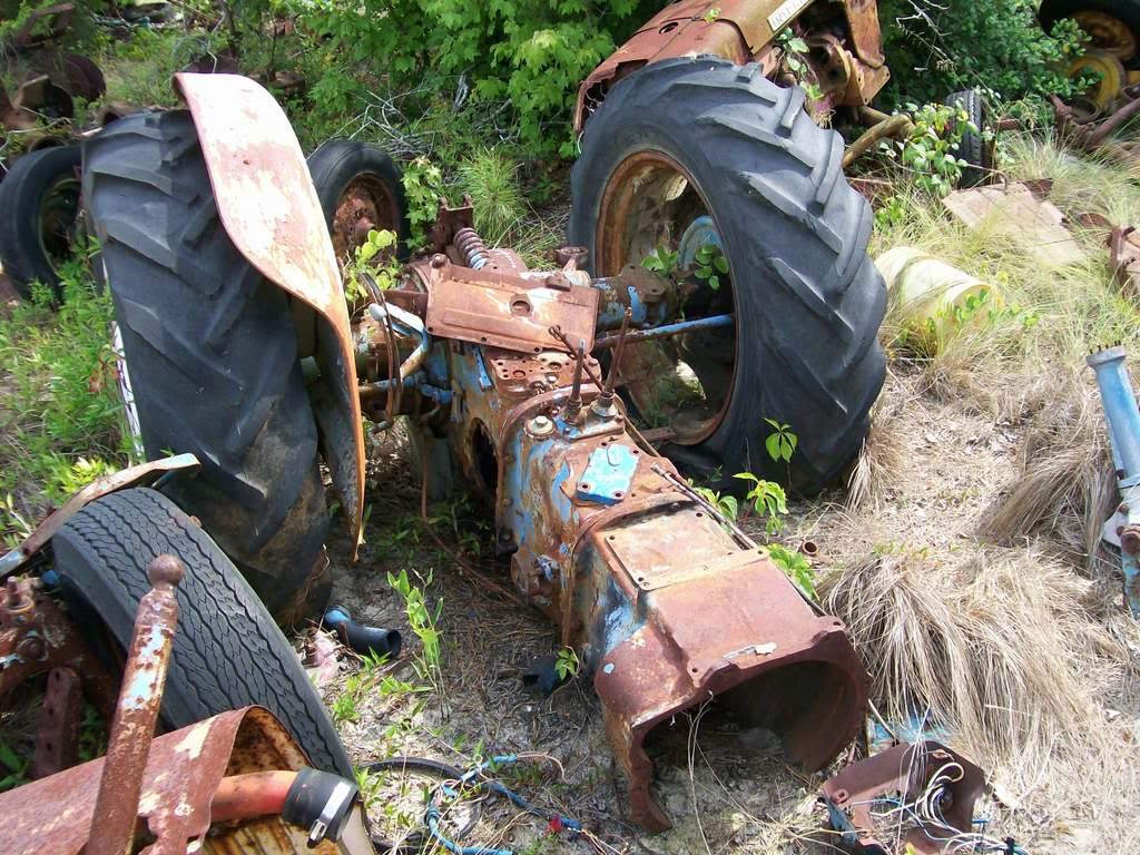

New Poster here. My first rebuild/ restoration project is underway despite what every tractorman said. What's up with that? My father gave me this tractor so I intend to see this project through. I have learned alot and been completely impressed with all the great information on this and other related sites. I'm still in awe over this whole world wide web thing... Are any of you fellow dexta owners near me..? Does anyone know of a tractor junkyard(parts museum) in the Charlotte NC (US) area? I was impressed with a couple of the out of country parts suppliers (Agriline, Vapormatic found in a tractor magazine) Are there any similar US companies or should I import? Has anyone compared pricing this way? Any help will be greatly appreciated from me "a dying breed" (someone who will try to tackle something that he knows nothing about)

Hi naildriver7 and welcome to the board. I live about 40 miles away from Monroe, in Sharon SC .
To answer a few of your questions:
I am not aware of a tractor breaking yard in our immediate area. There is a large auction yard in Charlotte called Godley Auction that I believe still holds a well attended farm equipment auction once a month.It's on hwy 16 on the northwest side of Charlotte, going towards Newton -Conover. You could give them a call, they may be able to point you to someone. (704) 399-9756 is their number.
Also try your nearest Case New Holland dealer. I'm not sure if there is one in Monroe. There is a large one in charlotte, just off 1-85 at Graham street.
I've done a major overhaul/ rebuild on a '59 dexta over the last year and bought parts both domestically and from europe.
I would reccomend buying all you can domestically..it's usually cheaper. Shipping costs from Europe are quite expensive, and the dollar / euro rates aren't favorable right now to those of us on this side of the pond. Plus, returns are much easier if you happen to have a problem.
There are many in the US advertising various parts for Dexta's on the internet. Two that I've done business with , and have no complaints about, are Yesterday's Tractors, http://www.ytmag.com/store/index.htm
and Walt's . http://www.waltstractors.com/acatalog/
If you haven't done so already, get yourself a parts listing and a service manual, there are links to free softcopies on this site.
Also, look at the data available on this site on serial numbers and casting codes and determine the year of your tractor. this can be important when looking for certain parts.
One more bit of advice, if you do any engine work, take it to a shop that will pressure test the cylinder head, and examine the block thoroughly for cracks, holes , etc. These tractors are getting to be 45 -50 years old, an corrosion induced cracks are fairly common in them. (search this forum, you will turn up quite a bit on the subject).
Good luck with your project.

Thanks for the reply Commander. So that's what you call it(tractor breaker yard) My Super Dexta is a 64 model and has the restricter adjusting knob on the hydraulics. I'm well underway in my exploratory teardown. My engine teardown revealed a spun bearing. No visable damage to the block yet most machinist say (without seeing it) that it will probably need line boring. I've not taken my engine to a machine shop yet because first, I want to check out the rest of the tractor to make sure there are no major problems. Second, I'm asking alot of questions to be sure I choose the most qualified machine shop. I have now found a couple of parts dexta's and someone to rebuild my injector pump for four hundred to six hundred dollars. Question: I have not yet separated the transmission, rear end and axle housing but everything else is on the floor. When I turn the clutch side brake shoe(by hand) everthing turned smoothly. When I turn the locking differential side break shoe there is a tight spot in it's revolution. Any predictions about what I'm going to find in there? After pulling the hydraulic cover/pump it looks like whoever owned the tractor before me used four parts oil to one part swamp mud in his maintence regimen.
